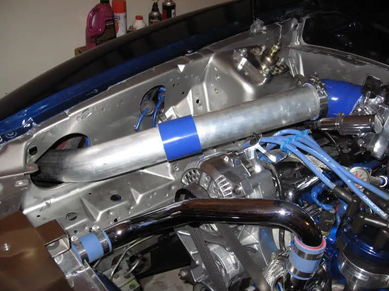

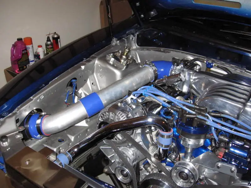

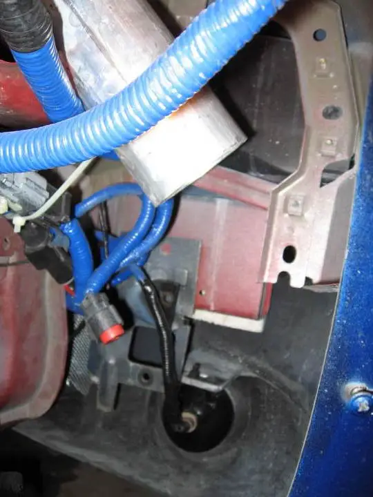

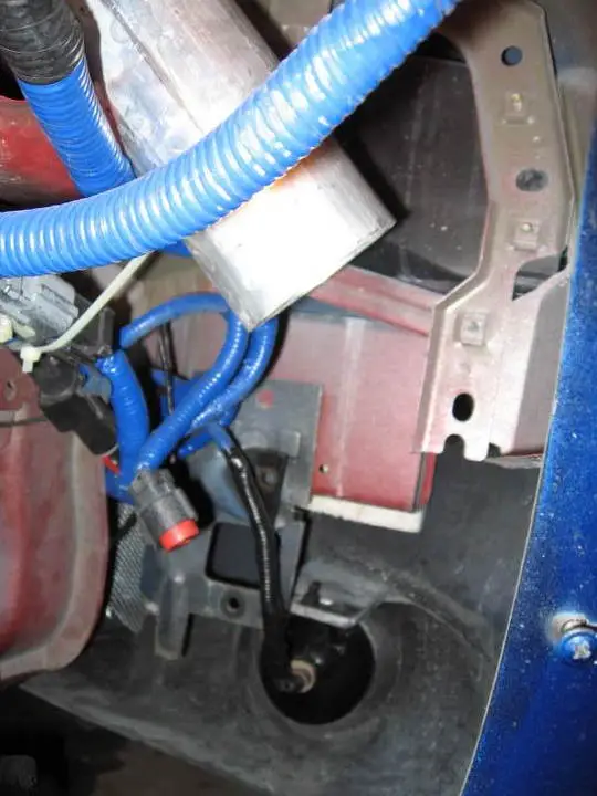

I got everything back together, I just need to figure out where to put my LMAF and filter. Here's the first set-up, the meter is right inside the fender parallel to the ground....

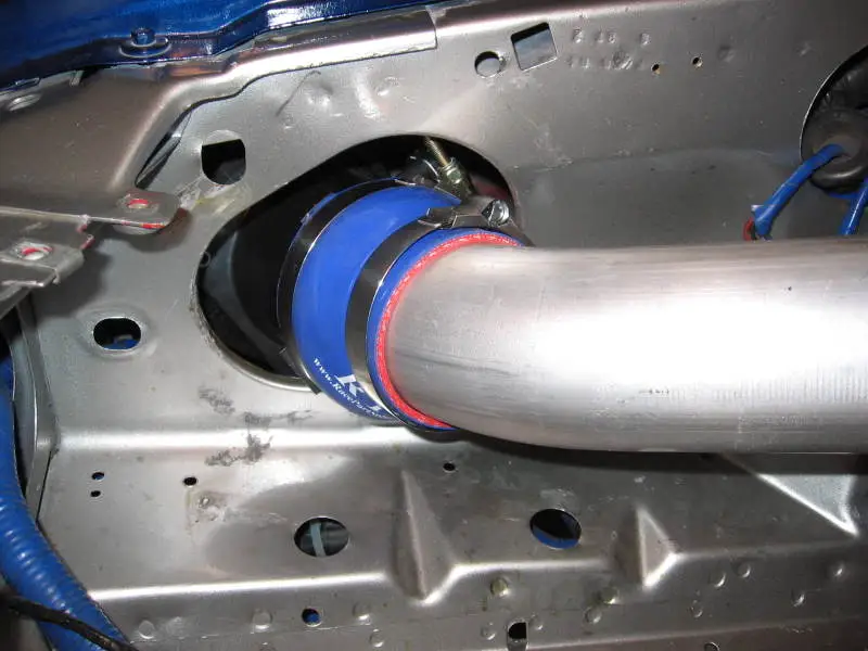

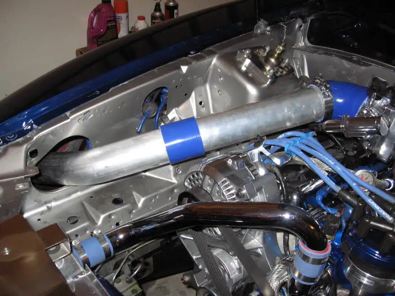

And then this way would have it the meter upside down, but completely out of sight...

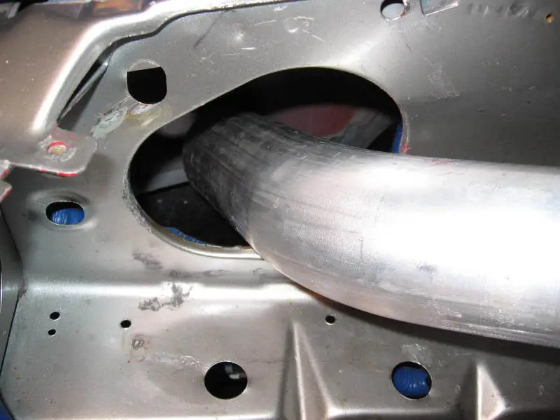

It would attach to the end of this pipe (pic is sideways)...
Thoughts?

i like the first.
1- less piping
2-easier to clock the maf if needed
are you going to use that coupler right in the middle between the 2 pipes? i would weld them together for a cleaner look
that would look great chromed
what size piping did you use?
I kinda like the first way also.

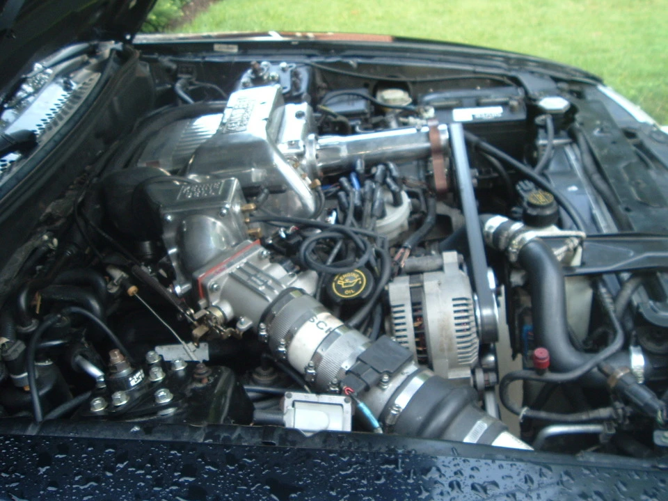

That engine bay is hot mang! I hate to go OT but where did you stuff the CCRM and what was involved (I'd like to get mine out of the way)?
i like the one with no bends between the maf and the air filter. if neither has any bends, i like the 2nd one more.

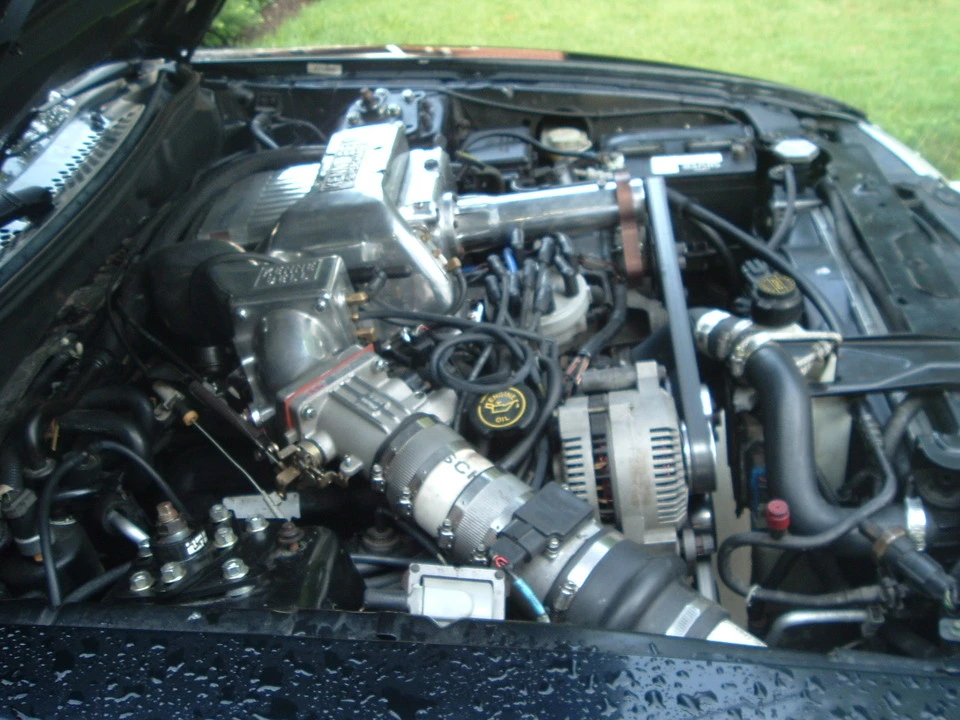

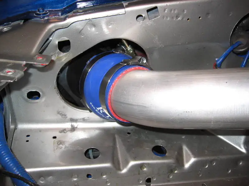

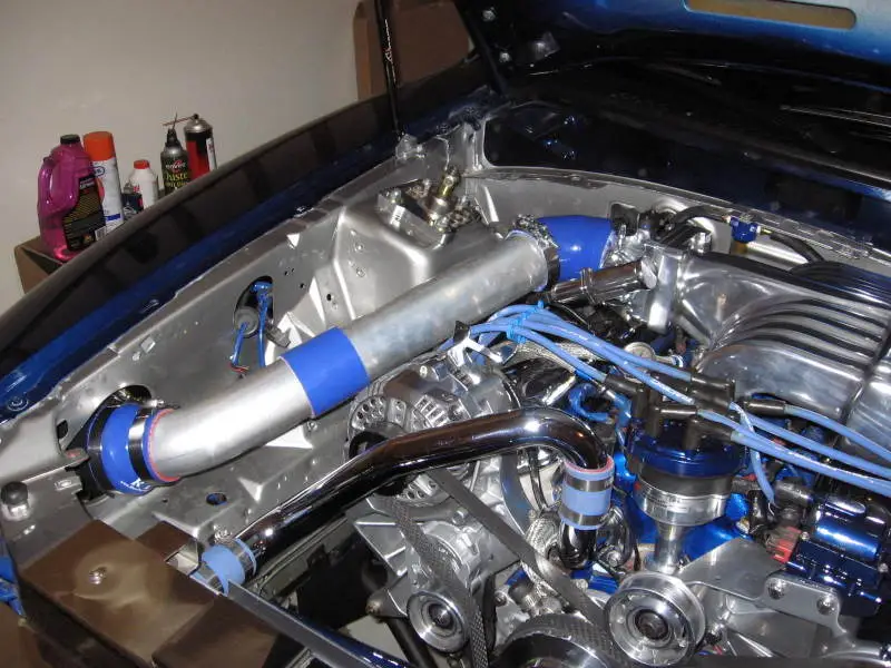

for the connector, if you aren't planning on welding it, check out the connectors i used. i know that my engine bay is extremely ghetto, but i really think these connectors are a little classier than the normal blue silicone connectors. and they have them at home depot ...
but it looks like you have a blue and polished/chrome thing going, so probably never mind
Thanks for your replies. I think I’m gonna do the first one. It’s less piping and I already have everything cut. I considered welding the two pipes together but for easy of assembly/disassembly I think I’ll use the silicone coupler; I will trim it down and make it as small as possible.
I got all of the silicone couplers from racepartsolutions.com including the 3” aluminum tubing and the t-bolt clamps.
Tonight I’m gonna drill a hole for the IAT and extend the MAF and IAT wires. Then I just need to get the tubes chromed. Anyone know how much chroming should cost? It’s about 20” of 3” inner diameter aluminum tubing.

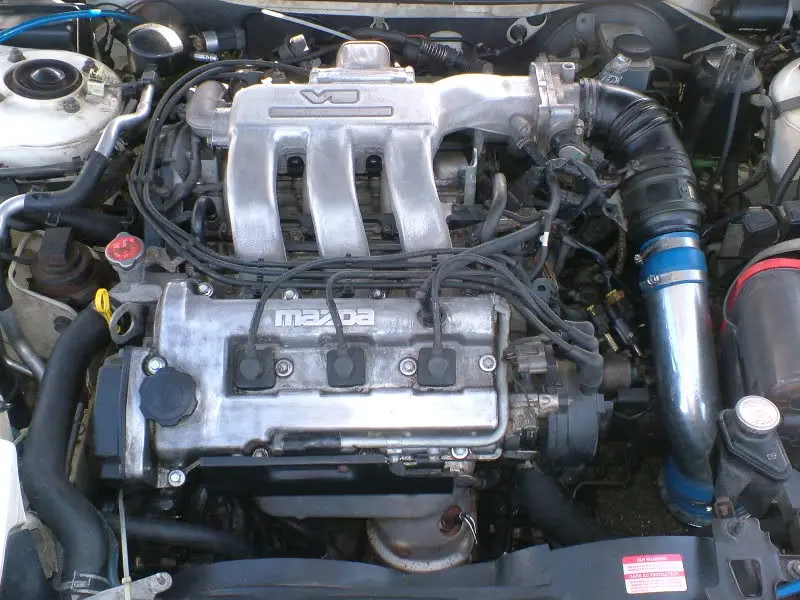

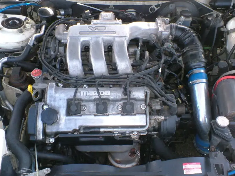

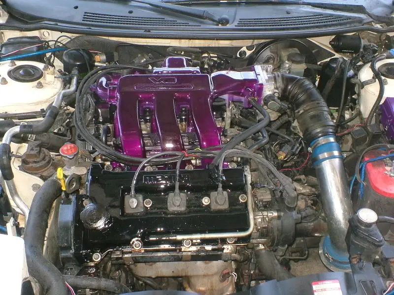

remember, try to keep it up as high in the fender as possible. I hydrolocked my car's origional engine with a cai gping through a puddle

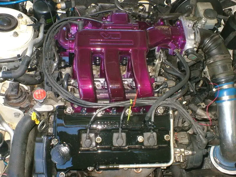

I had that problem with the probe because of the longer intake manifold of the JDM motor... so i ended up using the stock rubber elbo and even that made that filter dangeriously low... you cant really tell in this pic but it was basically resting on the splash sheild.... i think that saved me a fewtimes.... but yea go with the first set up... the maf probally likes sitting like that better anyway.... and i think it looks good it takes up some of the space....

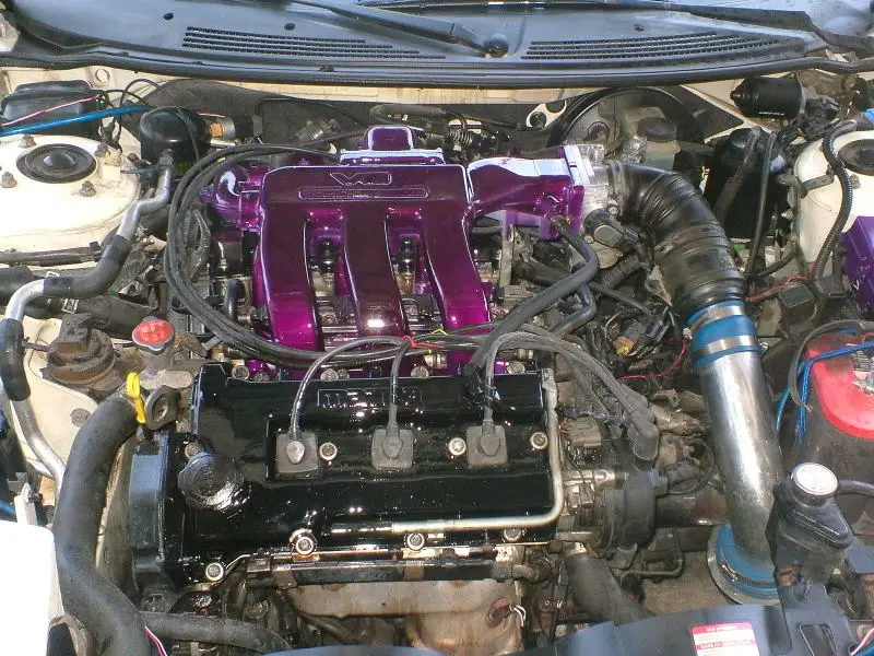

I had that problem with the probe because of the longer intake manifold of the JDM motor... so i ended up using the stock rubber elbo wand even that made that filter dangeriously low... i say go with the first one.... the maf probally likes sitting that way better anyway... better safe then sorry... ive seen 2 many cars going puddle jumping and getting hydro locked..... wouldnt want to see it happen again
