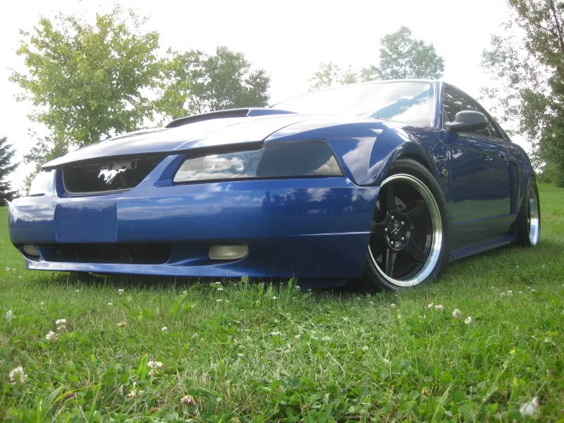

Funny you should mention this, because I have an 02 with a bit over one coil removed, and no isolators. The ride is a bit more harsh, but it looks a thousand times better. I still managed a 1.6 60 foot with these on worn out drag radials too.
OK! Wife has the same Sonic Blue '02 but with chrome Bullitts. We've been running the 17x9' rims for years now but it has always bothered me that the car sits so high above the rims in the front and would look much better if dropped about a half inch or so. Sounds like a half coil would do it. It almost seems like the rear coils are sagging a bit and throwing off the visual impact that wide rims would normally give.
