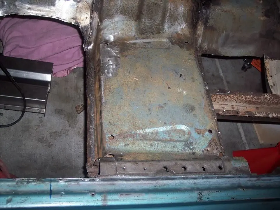

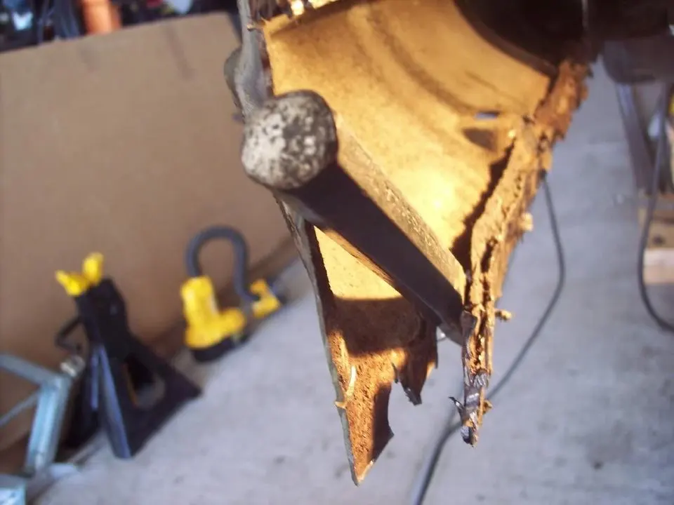

Picture of the seat platform
Hi Guys
Hope this picture of my Seat Platform and Inner Rocker area shows-up
Here goes :nice:
Here is the picture Schooner wants to post:
or
THANK YOU so much Geostang351 for posting my pictures.
In the 1st. picture you can see that I've cut away the rocker on the left and then some on the right. I haven't got to the rear of the rocker YET.
THE PROBLEM: As you can see I took-out the most of the spot welds except (2) at the left of the seat pan. Under the seat pan you see the differcult part of my problem: The rest of the Inner Rocker Panel that has to come OUT :bang:
MORE: under the seat pan the reinforcement platform lies. And that platform is also spot welded to the old inner rocker panel. The ol' rocker panel is sandwiched in between both pans.
What was suggested by another good fellow member of this forum was:
I was to remove the spot weld upper & lower on both pans and cut out/burn out/bang out/ however I get that ol' rocker panel out and then SLIP in between the new rocker panel without cutting out both pans. And then re-welding 'em back into place.
My question is: Can or will I have ENOUGH ROOM to SLIP IN the new rocker in between the seat pan & reinforcement pan?
I'm in your hands guys. What is the Best salution to this problem please.
GOD BLESS :hail2:
Schooner :cool:
Schooner :cool:
If you cut out all the old inner rocker, and clean up the surface of the lower seat pan and upper seat riser, you will have no trouble sliding the new inner rocker panel between them. In fact I always put a jack under the lower seat pan to close up any slight gap for welding. After you have cut out the inner rocker, front and rear floors and front torque box,with the front tire removed, start at the front and push/slide or drive the inner rocker into place. It is not uncommon to put a block of wood on the end of the rocker and drive it into place with a large hammer. I have done over thirty Mustang convertible floor and frame rail jobs, I think I have removed the top or bottom seat support on three, maybe four, and that was because of extensive rust.
