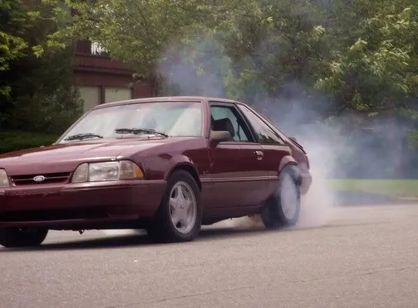

i cut mine a bit(maybe 3\4 coil) and the car hooks up great! (well much better compared to the stocker it had). no bad effect that i can tell
