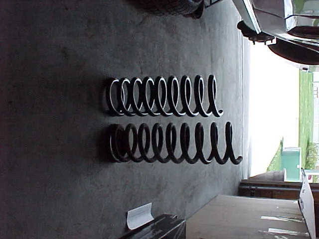

I used the 1" drop springs see the attached pics between stock and new ones
good luck
