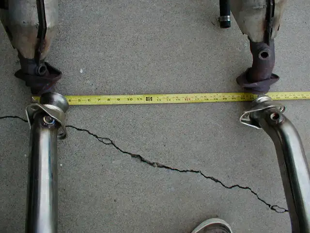

Anybody have this problem? Good thing I live near by. Now I have to un-install the X pipe and put it in my truck and drive it back to Magnaflow HQ. My Bassani X pipe that I sold to Goldmember fit much better. Now I feel dumb for making a trade like that...and it cost me so much money....DAMN!! :nonono:

Where the collectors connect to the headers is much too narrow. Id say it is about the total of an inch too close together. The pipes at the front end of the X need to be moved outward.

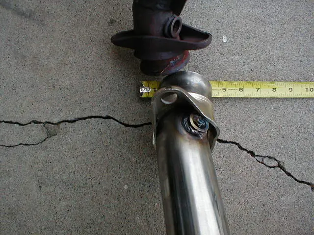

Look guys. Tell me Im not crazy. That is an inch difference! My Bassani was not even a little off, it was EXACT! If it goes on my car it will go on perfect, or it will be stock, especially for this money. A big company like Magnaflow not making the part to spec, is not acceptable.
You are not crazy. That's way off. Send them that pic and maybe one of it hanging from one header and not lining up to the other.
