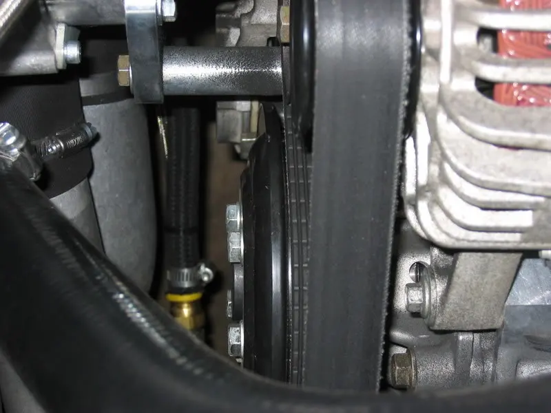

i only took one pic of the worst damage that i can see. please let me know if you think i should continue to drive like this once i post the pic. i dont think my builder doesnt think its this bad.
anyway, it looks like its almost over the lip on the water pump pulley.

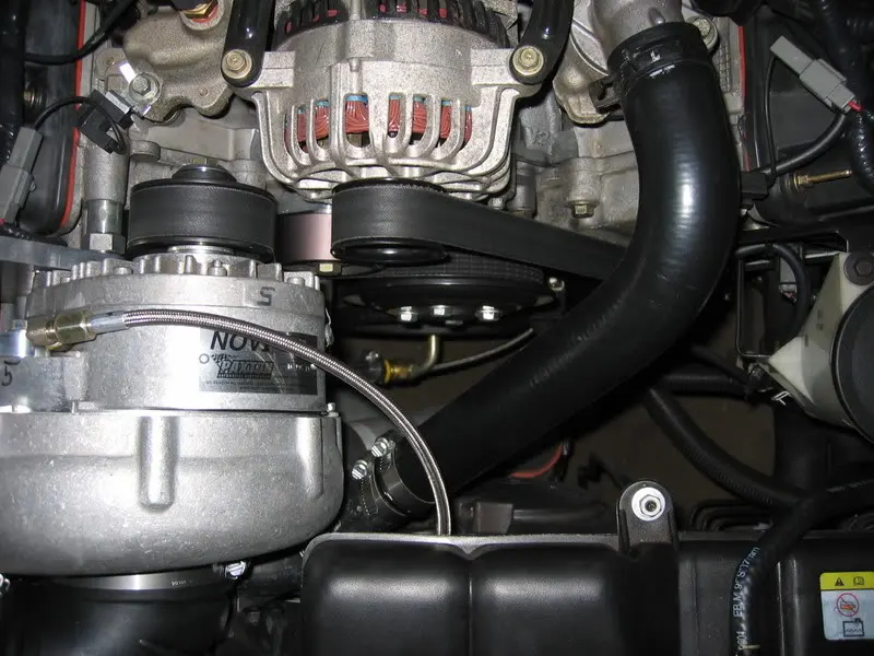

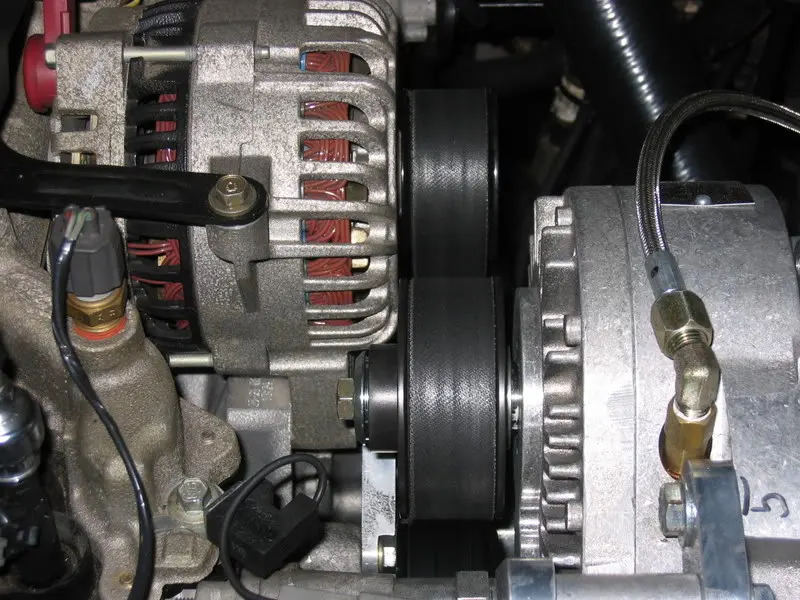

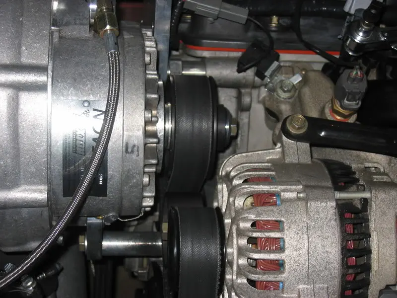

get the pics up if you can. one from the top looking down at the pulleys and one from the top looking over the pass side fender at the s/c and alt pulleys

in the pics the belt dont look too bad, but there are some spots where the belt has alot more damage. i thought the belt would wear evenly since it spins so fast but that is not the case. why would it wear worse in certain spots? hard boost?
Thats not as bad as mine was, mine would take out a few ribs. But it is rubbing and wearing when it shouldnt be. One reason it could be doing it in certain spots is because under heavy load there is some flex in the bracket and it could misalign stuff very slightly under heavy load to cause that.
