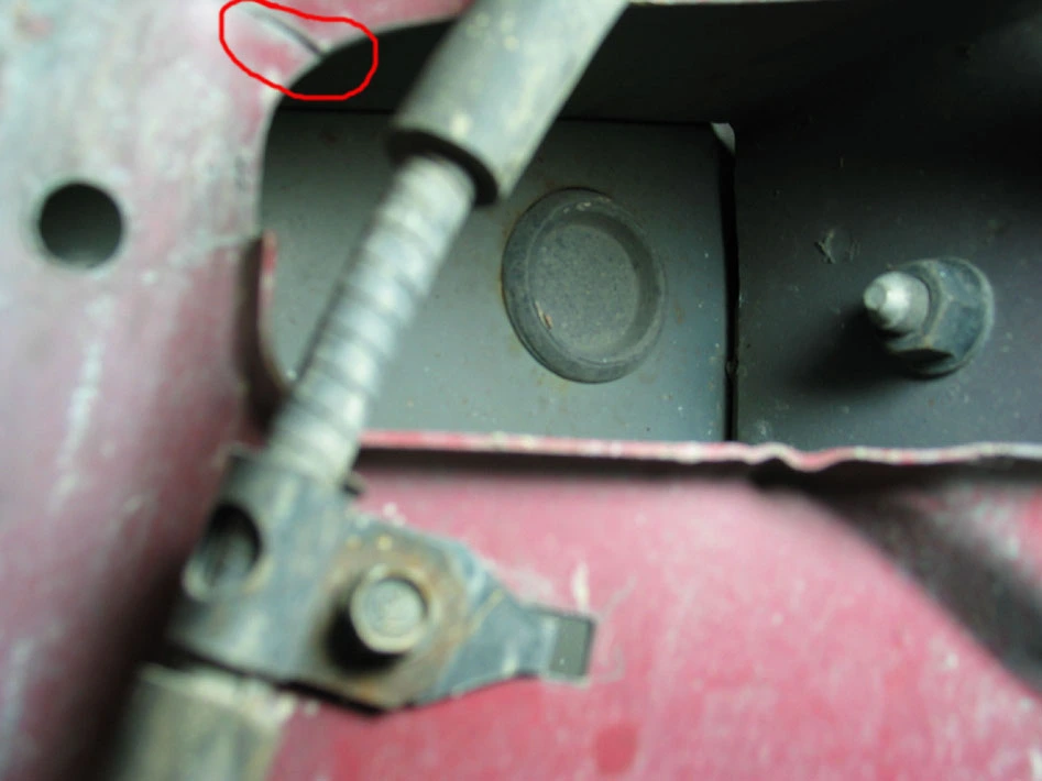

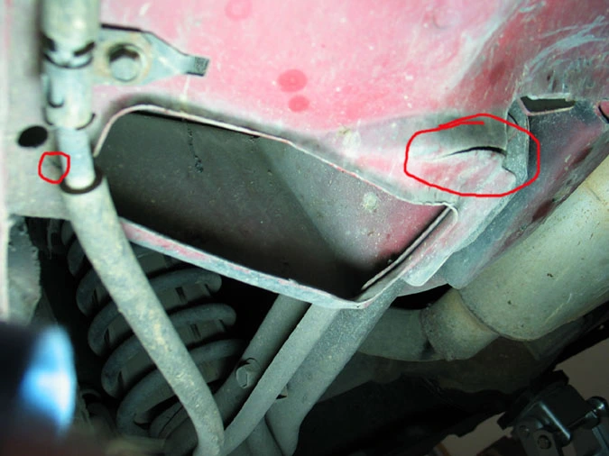

Here are the pics.
This is the drive side.
This one is the passenger side looking towards the rearend.

If you can weld, I don't really see any problems with you being able to fix that. It doesn't look like they were pushed out of shape. As Rick noted, just be very careful with that area.
Yeah that first pictures is how they crack when they hav been stressed, the second one appears to be from stress while jacking.
Weld the cracks up, add a re-enforcement kit and you should be good. If you just weld the cracks they will most likely crack again or in a different place. Add a set of subframe connectors and jack from them!

They don't look to be that bad at all. I would still put in battle boxes of some sort. The first could still also be from a jack depending on where they jacked it up at. better safe than sorry though. Mine aren't cracked but I am going to install some as a protective measure. That is if rick91gt gets back to my email I sent him.
Drill a 1/8" hole on each end of the crack to stop in from spreading. Then have it welded. Stop drilling the cracks is an aviation trick that has been around as long as there have been metal airplanes.
5.02GO said:
Uh, they're not out of shape. They just have cracks.
Yeah they do not have to be out of shape to crack, it is all about the stress put into such a weak area, that first crack is identical to where they usually crack from stress.
Like mentioned above, drill a stop hole and weld them up, then pick a lower kit to make sure they stay is shape in the future.
