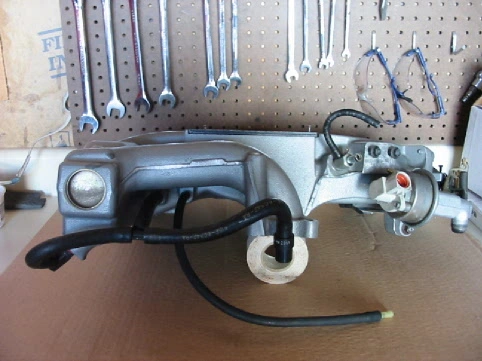

BlackVert 15 Year Member Oct 3, 2003 5,589 9 98 Bethesda, MD Jul 6, 2006 #1 Jul 6, 2006 #1 ugh. it's unbelievable, it sucks just as much oil as when the blower was on. maybe i don't have the vacuum tubes right? anyone have a diagram?

W wytstang Mustang Master Mar 14, 2004 4,988 4 78 Summerville,SC missing South Fl. weather :( Jul 6, 2006 #3 Jul 6, 2006 #3 Attachments intake_hose_routing.webp 54.7 KB · Views: 103
