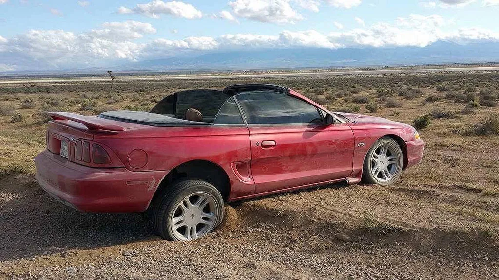

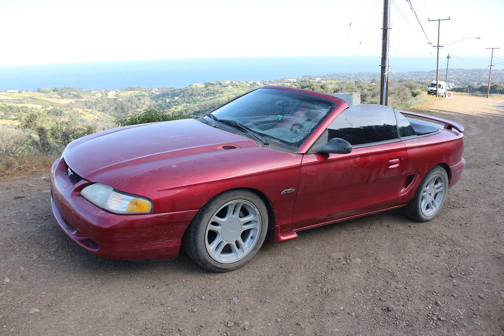

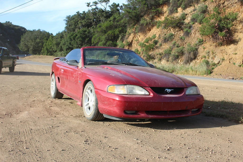

This past weekend I took a super long Greyhound ride to LA and picked up the Mustang. While I was in LA I took it to some nice canyon roads in Malibu which was a total blast. I then drove it all the way back home to Phoenix, which went off without a hitch. Here are some pictures I took of it while it was in LA:
It was absolutely filthy from being thrashed around on a dry lake bed for the video shoot, and the side skirts got torn off. I still have them along with all of their clips, they were laying in the front seat. It's also way too low thanks to the ghetto spring cut job (we cut 2 coils off the front springs and 1.25 coils off the rear springs).

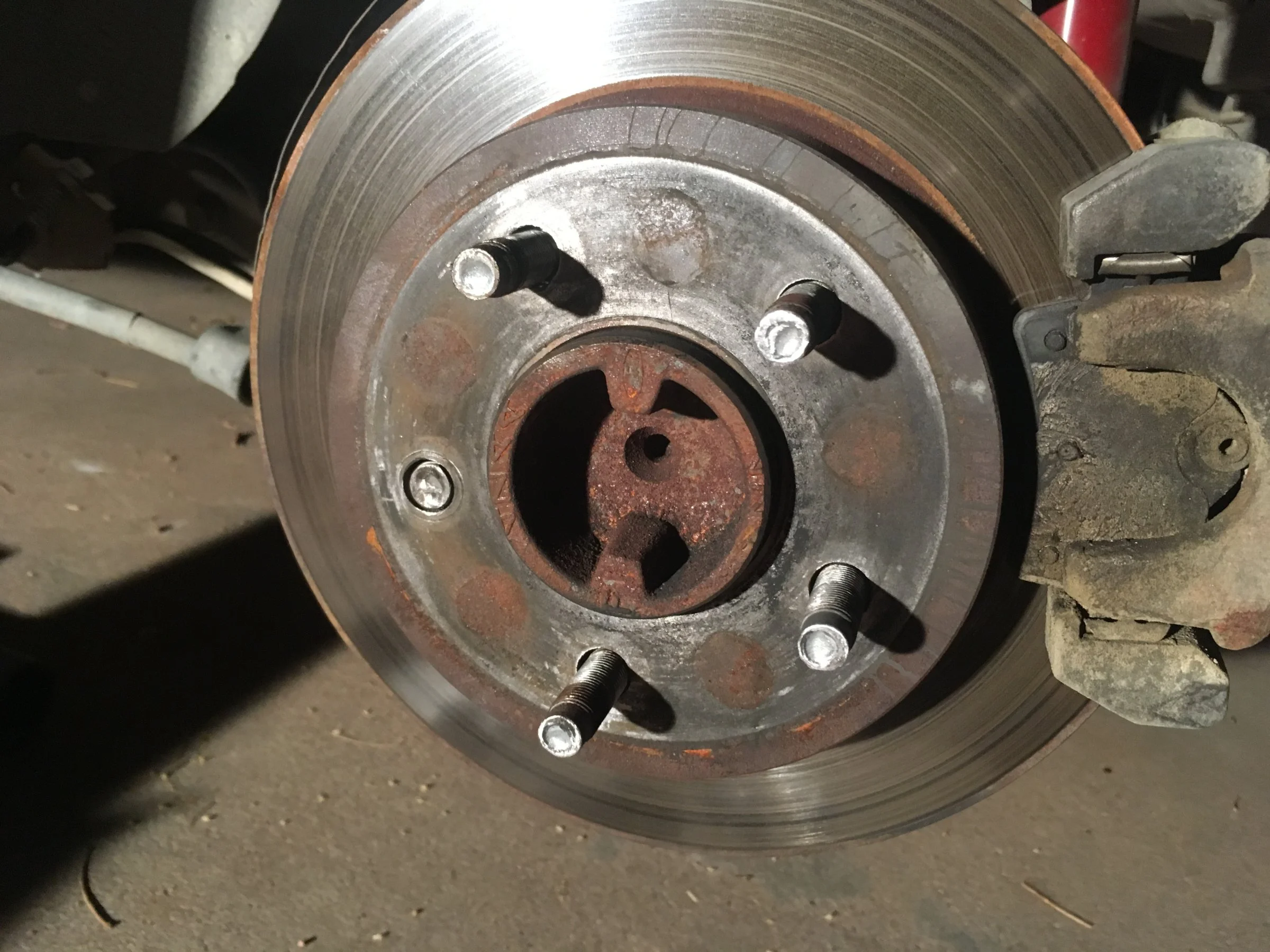

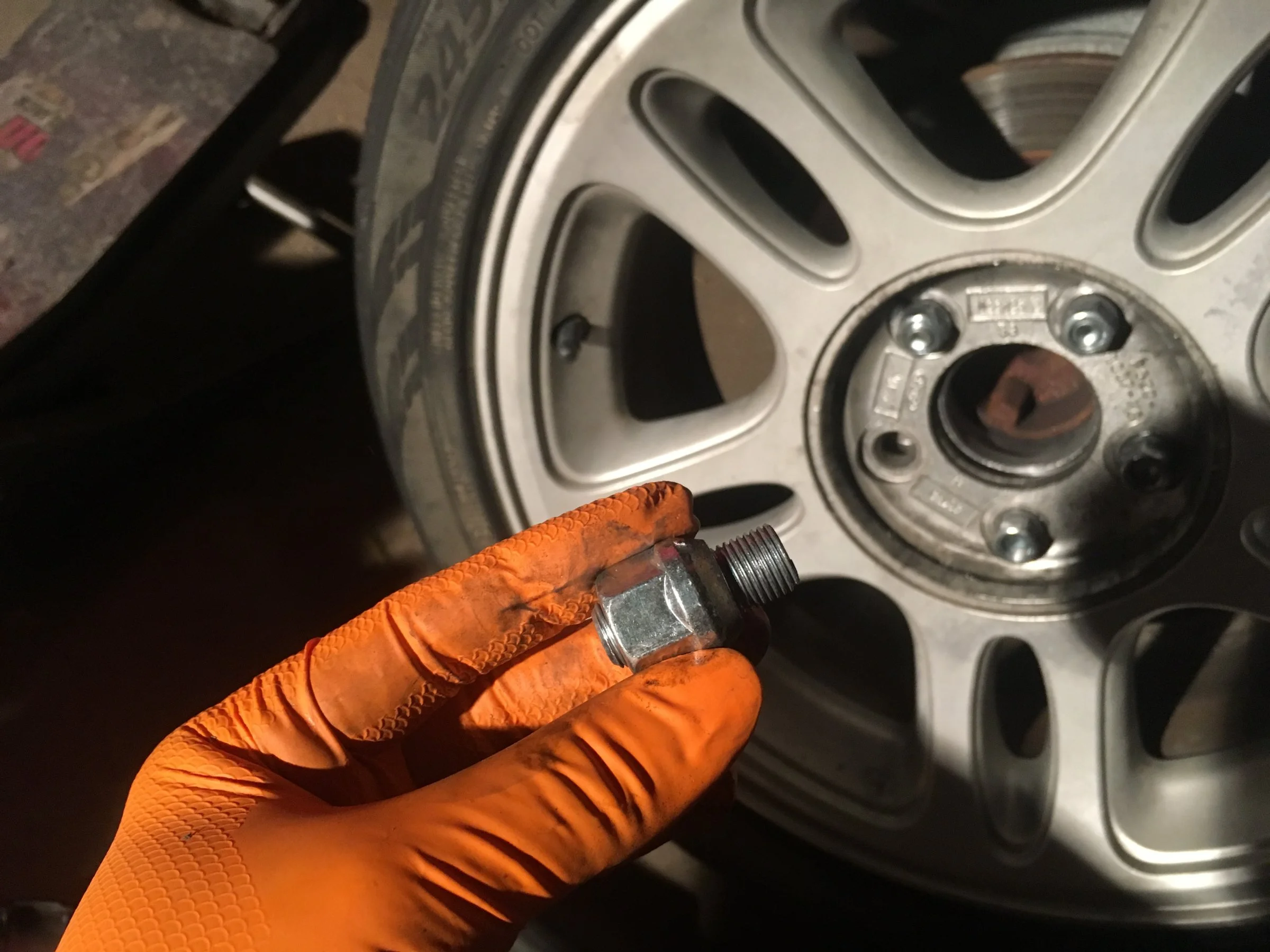

While getting gas later that night, I heard a squeaking from my rear left wheel. Initially I thought it was just a bad wheel bearing or a stuck caliper, but then while filling up at the pump I noticed that the rear left wheel was sitting really crooked. Imagine my surprise when I found that the wheel was completely loose! I could move it around easily with my hands. Since this car doesn't have a jack or any tools in it (did those originally come with the car?), I had no choice but to carefully limp it home. Thankfully the gas station was less than a mile away from my house so I made it home with no mishaps.
As soon as I pulled into the driveway, I removed the lug cover on the wheel and a broken lug + piece of wheel stud fell right out, yikes!
This was the stud from the spacer, so I removed the spacer and found this:
All of the nuts were extremely loose, which was quite odd considering that I had torqued everything at least a few times when originally installing it.
After a bit of investigation I deduced that it was because the spacers were cheap pieces of crap. My friend bought them on eBay for $20, so in retrospect I'm not surprised that this happened. The spacers were not hubcentric since they were a generic fitment, and that probably led to vibrations that loosened the wheel nuts. It's crazy to think that I drove it from LA to Phoenix like this! I'm so thankful that nothing bad happened because of this.
I guess I'll buy some brand-name, hubcentric spacers from a reputable seller to replace these sketchy ones. I also need to replace that wheel stud, which looks fairly easy based on what I've read. I picked up a few studs from Autozone last night, so I'll be fixing that this weekend.
