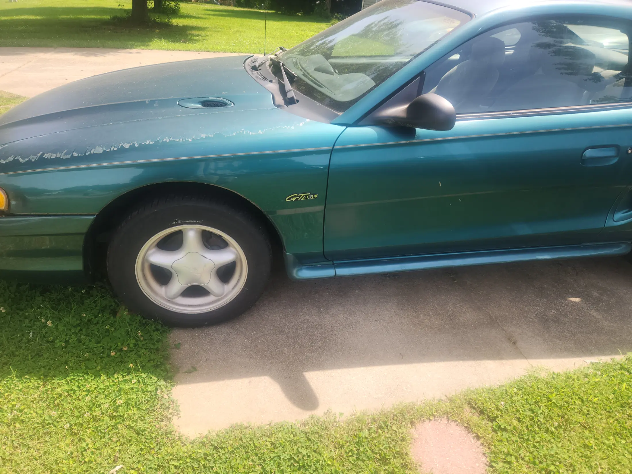

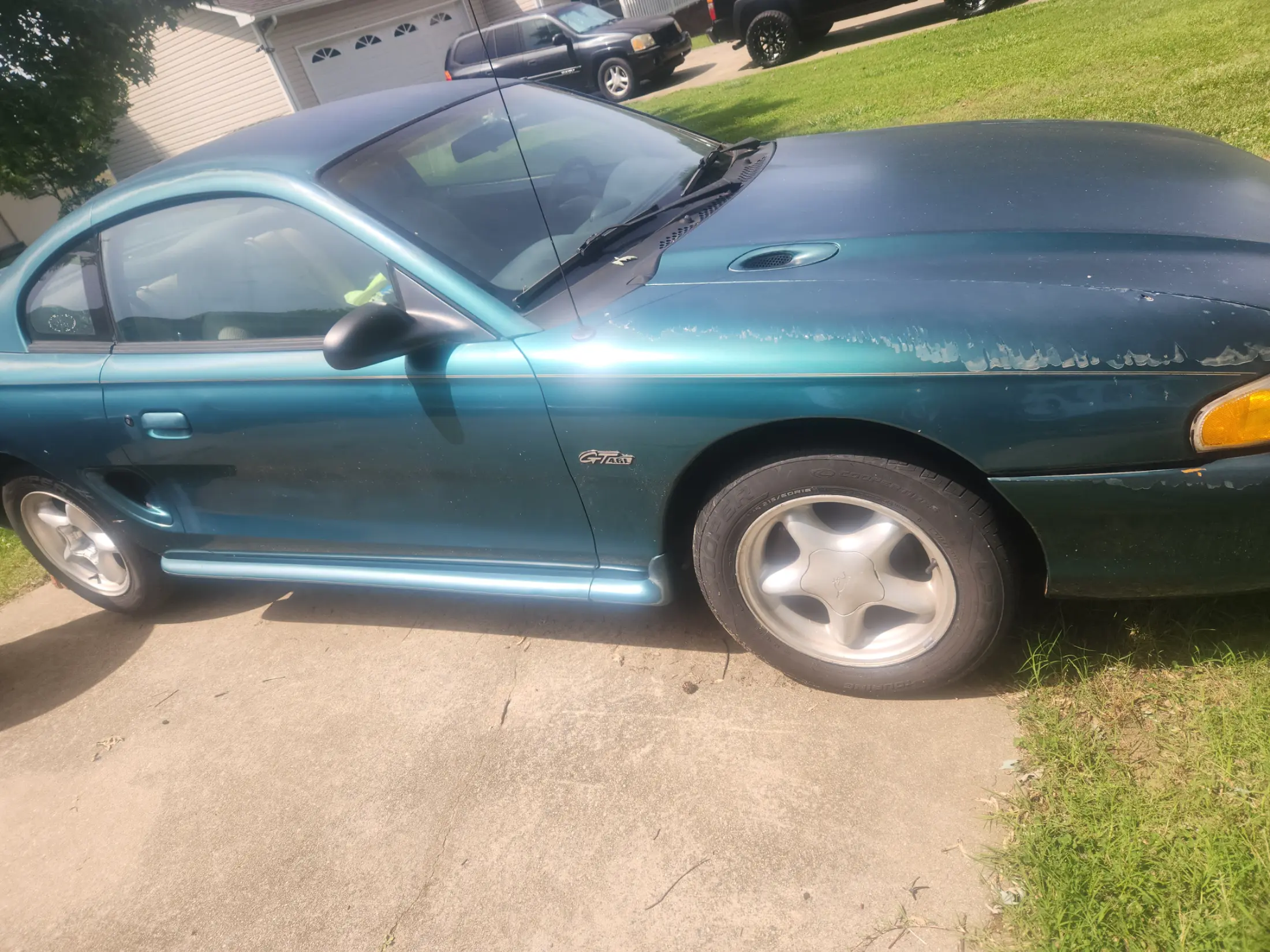

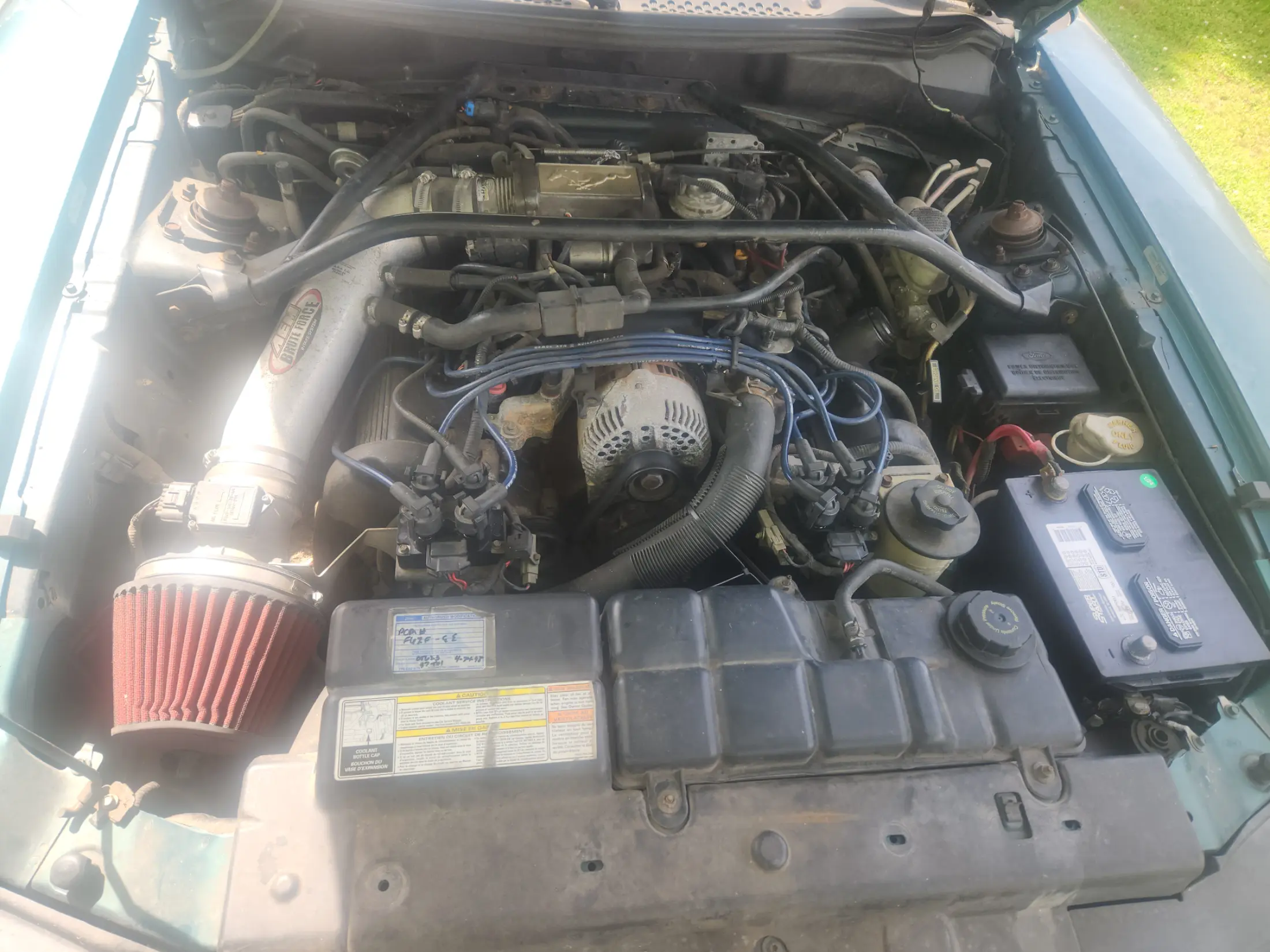

Funny thing is I haven’t named it yet. Here’s some pics from when I first got it.
