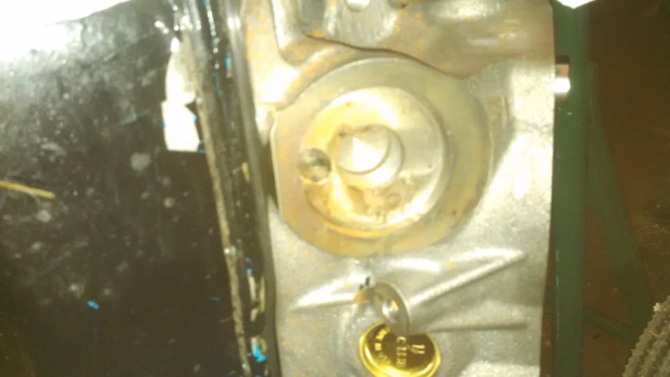

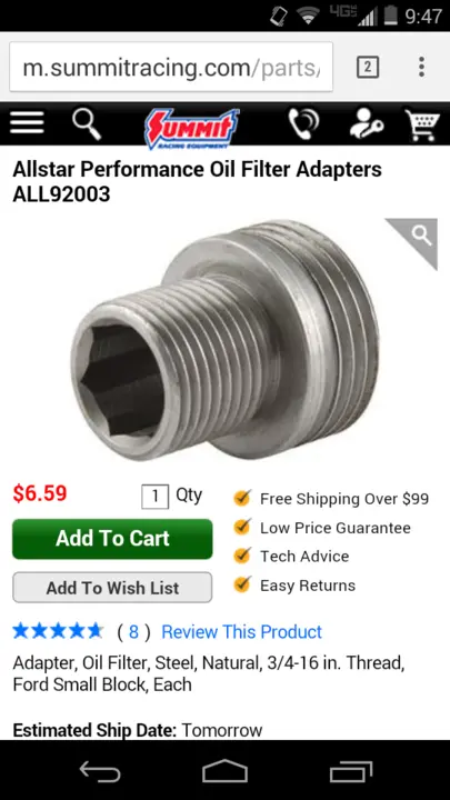

Finally got my shp block 347 rotating assembly finished, what oil pan fits best as there are no provisions in block for dipstick tube? Didn't realize until buttoning up bottom end? Also do I need a oil filter adapter? Just a threaded hole there?
Is this all I need for the filter?

You need to run the 7 for the bigger pan and pickup . I put a canton. On mine as I had the same issue and didn't realize till the motor got here .
