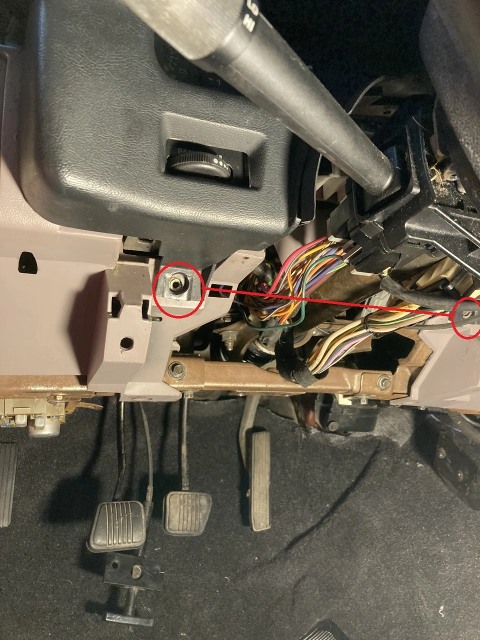

While reassembling the dash on my '91 I find I have misplaced the screws that locate in the red circles below. Does anyone know the size?

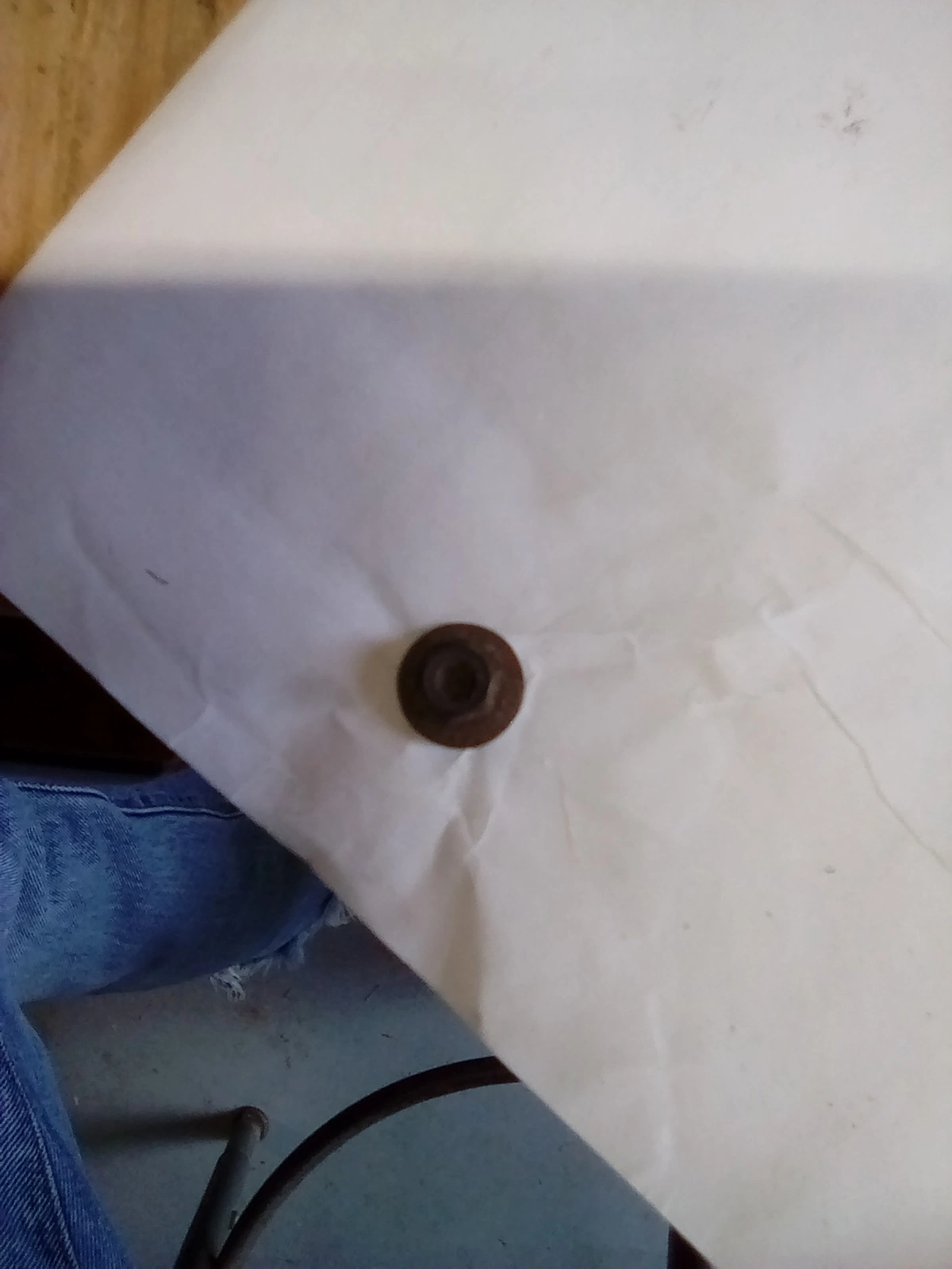

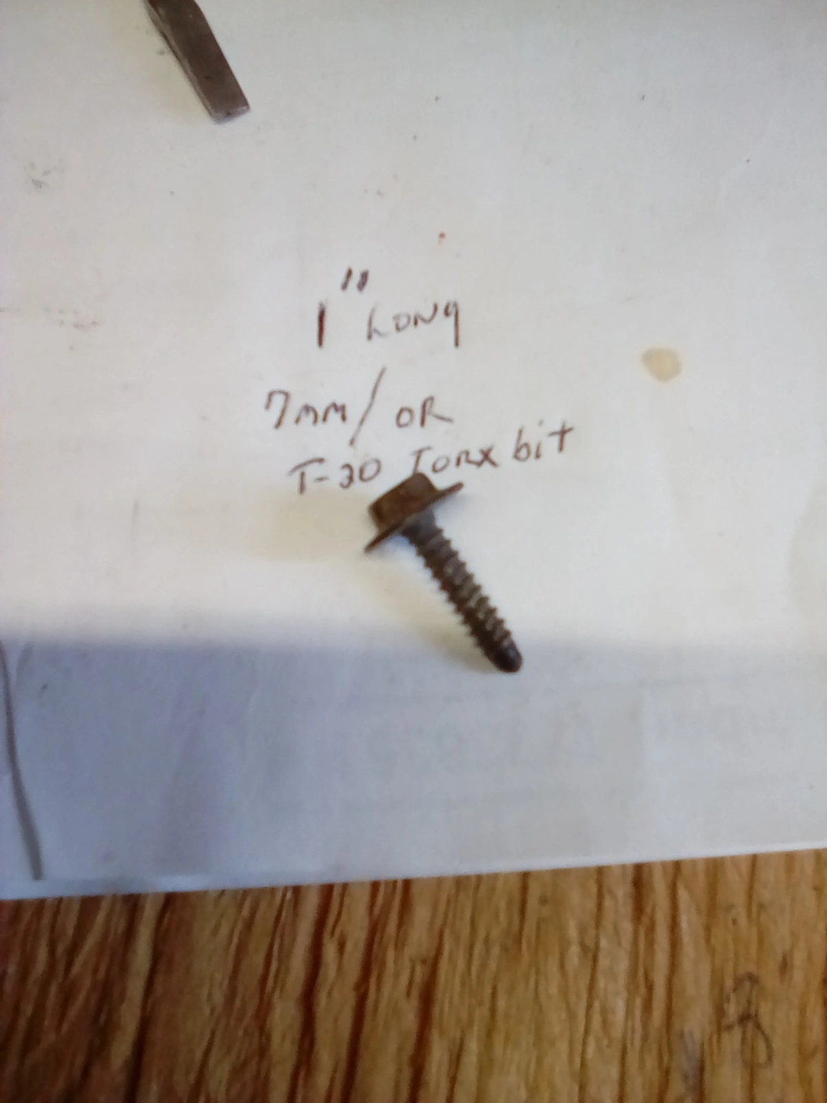

The center of the screw has a t20 torx or you can use a 7mm socket
course thread 1" long
Caution: hand tighten only /snug, anything more and you break the plastic
