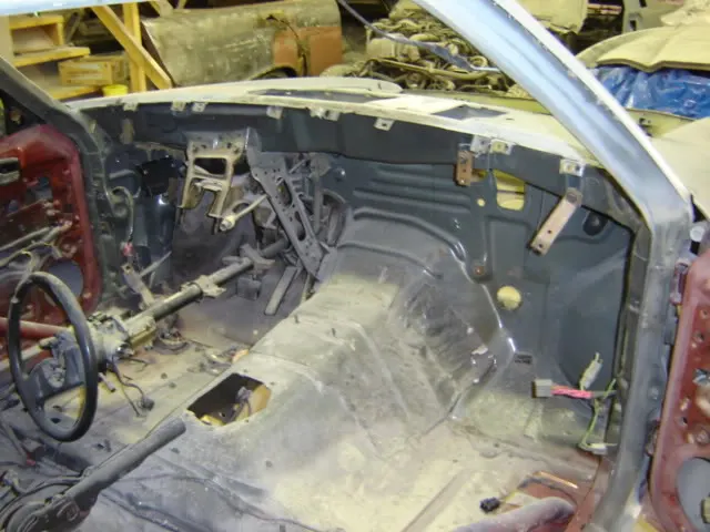

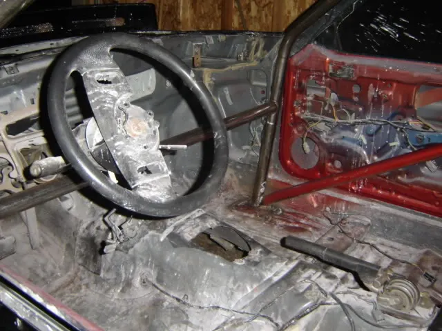

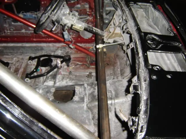

:stupid: Take your time its not that hard just think if you had a cage to go around..:nice:
