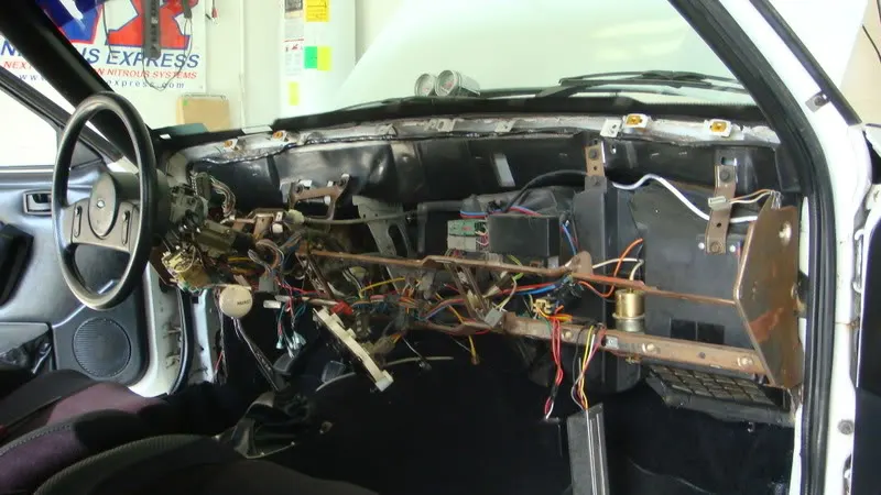

Here's a '90 interior in my '88
The only real differences in fitment are the AC controls - the 90-93 mount differently than the 87-89 controls, so I would recommend using the 90-93 controls if you can. You will have to extend the yellow defroster damper vacuum hose a small bit since the control is moved to the right side from the left, but it all works. Or you can drill a couple of new holes and mount the old panel in the newer dash. It will be covered by the trim anyway.
Also the fuse box mounting is different. The 90-93 have the fuse box under the dash, not behind a removable panel like the 87-89. You can mount it under the dash (a bit of a PITA to get to the fuses unless you get the 90-93 metal frame that folds down) or you can cut out a hole in the 93 dash and mount it in there under the knee pad. Just omit the metal backing panel from the knee pad and it works fine.
