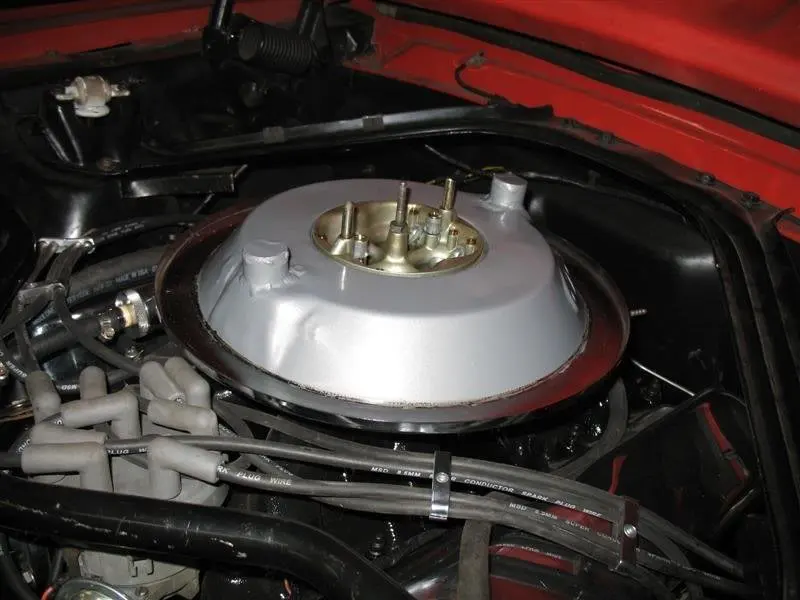

An air gap is tall, so you you have your work ahead of you if you do not put a hood scoop on. I don't know how much different height-wise an air gap is over a Vic Jr, but with a few mods I installed the that intake under my 65'. I angle milled my intake's carb pad .300" to get a better hood angle.
Other things to try:
Invest in some lowering motor mounts.
If this doesn't get you all the clearance you need, I modded my drop base even further. I simply cut the base's carb mounting lip down and gained about 3/8-7/16" more clearance. I also needed to make little closed off tunnels for the Holley external float adjusters to fit in. This mod on the drop base Holley air cleaner gets you nearly 1 7/8":
