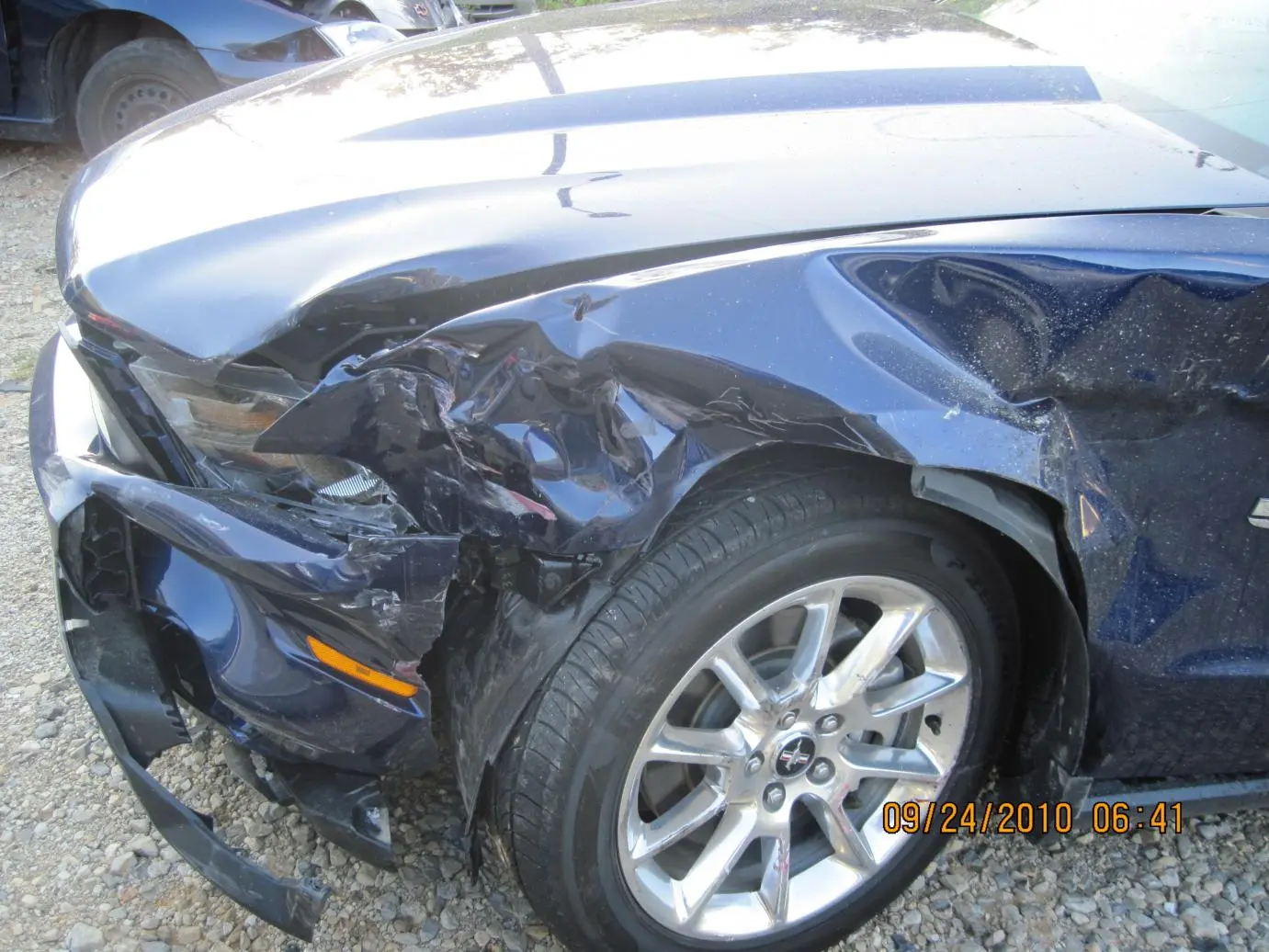

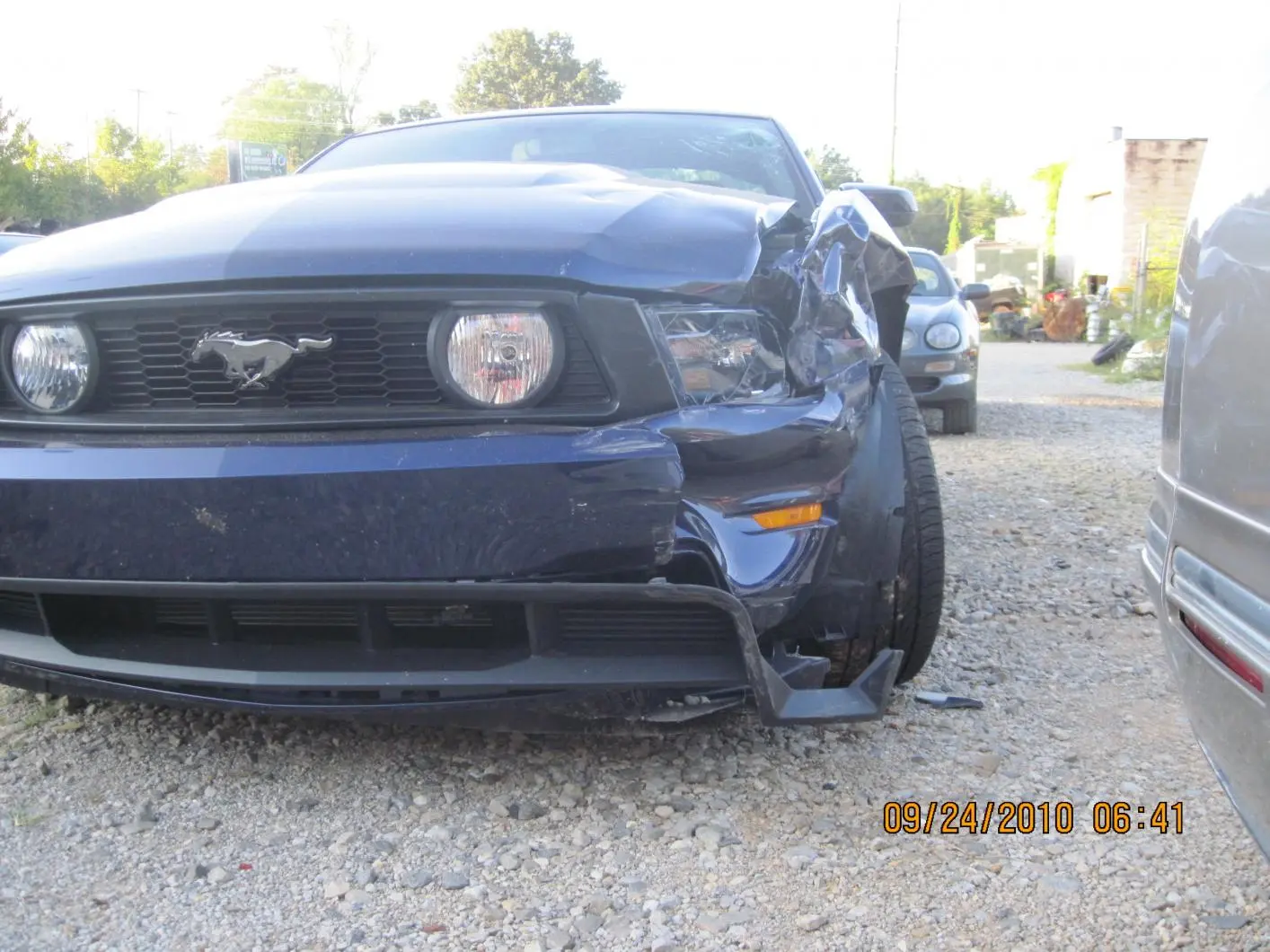

Just found this thread and thought I would share my own repair saga. I too have a kona blue 2011 gt. Bought it on July 17. Got hit on Sep 23. Damaged parts include:
  • hood
  • windshield
  • drivers door
  • both fenders
  • left inner fender
  • fender apron
  • and the other stuff as you can see
It has been repaired and reassembled now. But when the airbag light still would not go off they had to take it to the dealership. After two days. I was told the occupancy safety module was bad. It is on national backorder until March 21 2011!
