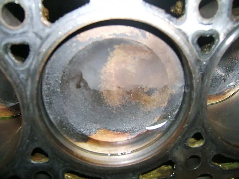

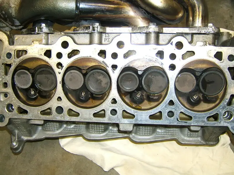

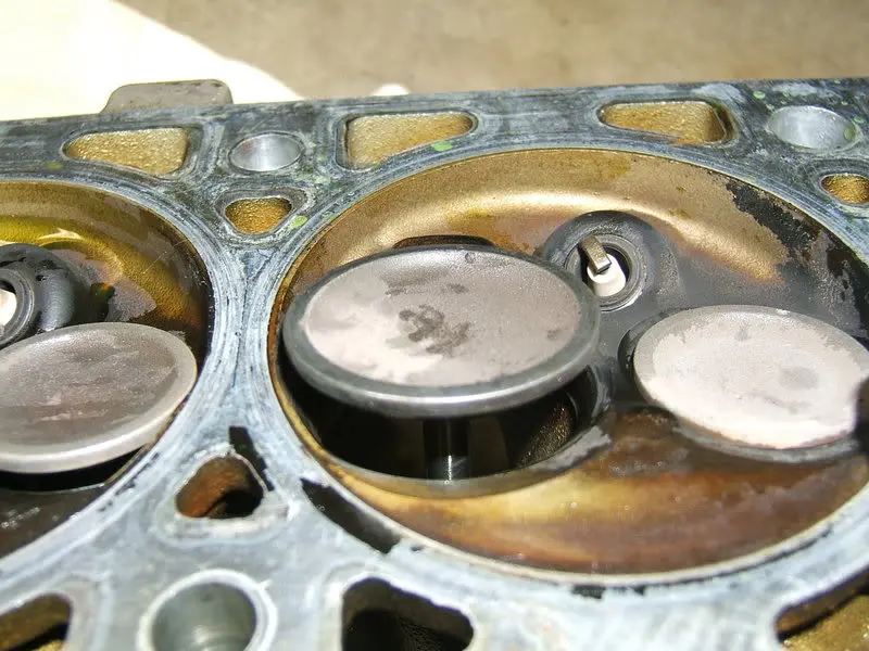

Ok, cool. Thanks for the advice. I'm picking up a new copy of MM&FF tonight. I'm taking the heads off this week to inspect the damage. I may be looking for new heads and pistons soon :( At least this will give me an excuse to go ported heads and forged parts.

Stock cams....no. Also, the piston dish volume has nothing to do with whether or not to degree the cams. All pistons have that flat area around the outer perimeter of the deck which measures roughly 10mm wide (9-12 mm depending on dish volume). This is where the valves will contact the piston, not in the center portion.
This is why you need to degree the 270 cams. I had some PTV contact and maybe screwed up my valves? I'm not sure. They look fine but can you tell just by a visual? What do you guys think I should be concerned with?
