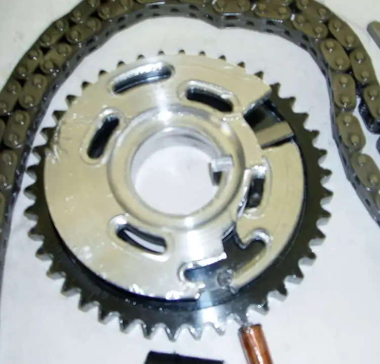

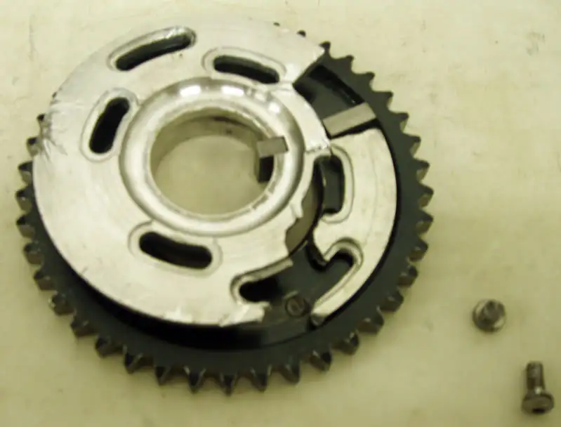

The only way a billet cam gear fails is due to improper installation. Period....and don't even bother trying to tell us that they were installed correctly because I know better. Those are billet gears not cast, and it's even evident in your pictures due to the nature of that fracture that they were either significantly over torqued or you degreed the camshafts wrong. We know several Fidanza dealers here in Central and South Florida and trust me when I say this.... there are literally hundreds out Fidanza cam gears out there with not a single problem. We have installed Fidanza flywheels, clutches, and gears for years now without ant problems.
I can post pictures all day long of broken parts in our shop... Does that automatically mean that the company that made those parts is somehow incompetent or has a widespread problem with parts failing? The answer is no.

the bolts loosen up and the center walks causing ptv etc...my builder steenracing won't use them unless you insist. It is a flawed design...modcamponents makes a far superior product.
