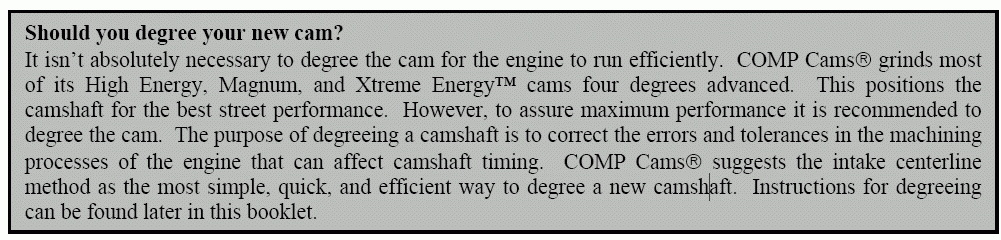

I think some people do not understand what degreeing a cam is for. It is to make sure the cam is correct and installed correctly. You would not be the first person to get the wrong cam from the manufacturer. How would you know? When you degree the cam you should not only be checking the intake centerline but valve lift, 0.05 duration and adv duration of both intake and exhaust. PTV is another story as is checking spring seat pressure, open pressure, coil bind, retaner to guide / oil seal. Just because the manufacturer says that there will be no PTV problem is not a reason not to check things. BUT IT IS YOUR ENGINE
Alright that's cool. And alls Hot's saying is that some people don't have all the required tools for a "proper" degreeing of cams and that if they have VT Stage 1's they don't have to worry too much about PTV contact as long as the Stg1's go in the same way the old cams came out. Obviously if a shop does it I'd expect them to degree it to a professional standard and quality, but for the DIY'er with THESE CAMS ONLY they don't have to worry too much.
Sure PTV contact is not a big concern when installing a tiny Stage 1 camshaft with everything lined up correctly, but camshafts can vary even from the same manufacturer and even the same batch. Everybody's valvesprings will vary, timing chain stretch, the condition of the followers, etc., etc.. You people installing your own cams should be checking your ICL's, your gross lift, your IVO, IVC events, etc. But like Stan and Matt said, it's your motor. I wouldn't even think of not degreeing a cam correctly on one of my cars no matter how small the camshaft was.
There is something that is also important. In my opinion the entire reason people choose to install a aftermarket camshaft(s) is to gain performance. Manufacturing tolerances, chain stretch, crankshaft aligmment, cylinder head deck thickness, ground in advance, can all effect the outcome of the relationship of the camshaft and cranshaft. The Stage 1's provide relatively small power gains as it is, so that to me makes it even more important to properly degree them with dial indicator and wheel to ensure that you will be optimizing the cam timing and then the tune. Afterall that is the goal with installing aftermarket camshafts...to make more power.

The engine is a 4.6l 2v 9.0:1 cr with 271 degrees intake @ .008,
115.5 CL, 115.5 LSA IVC 71 ABDC you will have 161 PSI cranking pressure and 6.847 DVR
111.5 CL, 115.5 LSA IVC 67 ABDC you will have 168.7 PSI cranking pressure and 7.079 DVR
119.5 CL, 115.5 LSA IVC 75 ABDC you will have 153 PSI cranking pressure and 6.605 DVR
Why you degree a cam or one tune does not fit all the same.
