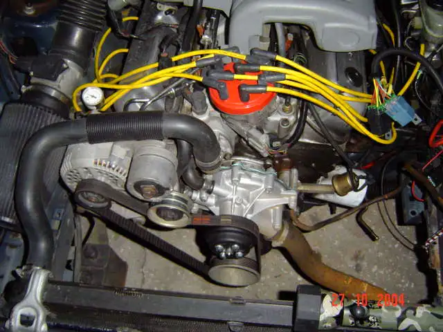

I dont have good pic of myne,but what i did was just use all the stock stuff and the tensioner isnt reversed, to get the belt on i loosen the tensioner enough so that the dowel releases and put the belt on then use a wrench on the tensioner pulley to get the belt on and tighten the top bolt back up.
This isnt the ideal way to do it like just getting a standard WP, but its worked for me for the last 2 summers, the belt squeals on a cold start, but other than that it makes no noise. I could find out the belt size if you dont feel like changing the water pump
