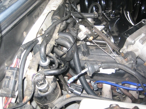

Here's a somewhat crummy shot of my EGR block plate - picture was taken in the middle of installing some parts (look behind throttle cable).

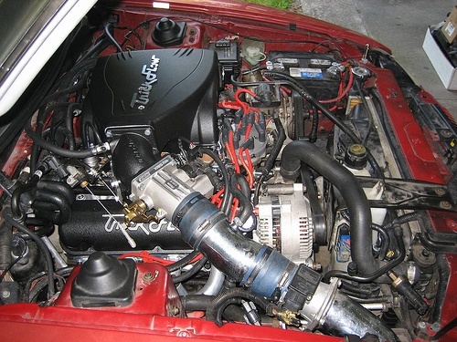

Here's a better picture I've got from another install...
