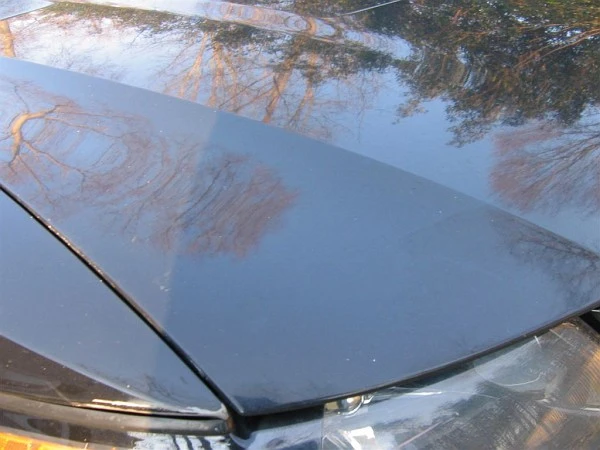

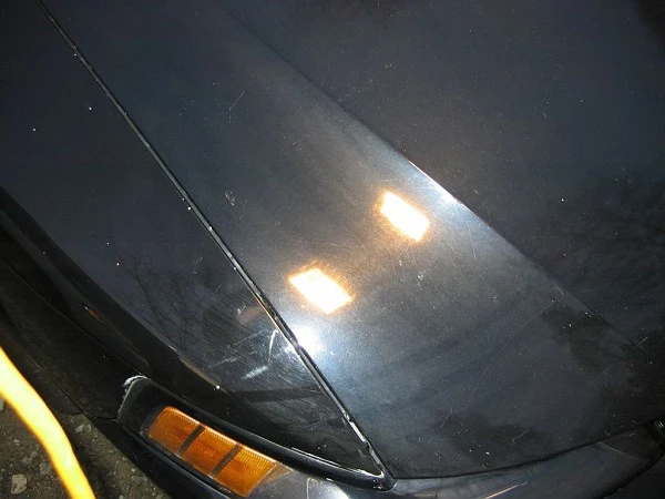

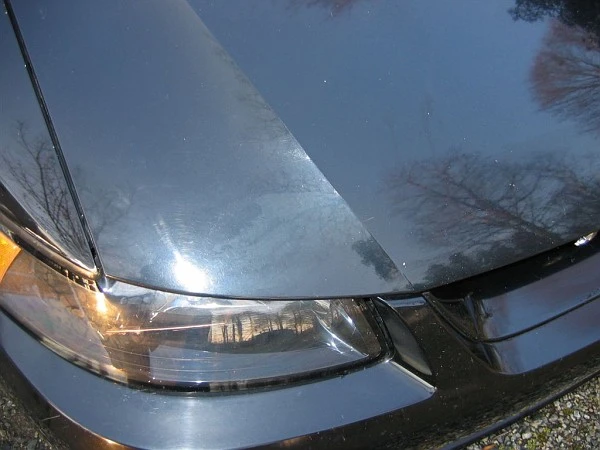

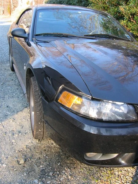

I've been doing some heavy detailing and corrections on my black 99 Cobra. I just love working with black cars! The results are always worth the work! Anyways, I have several pictures that span several detailing sessions. I basically tackle one area at a time since I usually do not have the 8 - 10 hours necessary to get the whole car done in one shot. The pictures should speak for themselves though. If anyone is interested in the processes I used just ask. Different areas required different products, tools and processes.
Here are the befores:
Now I get to work...

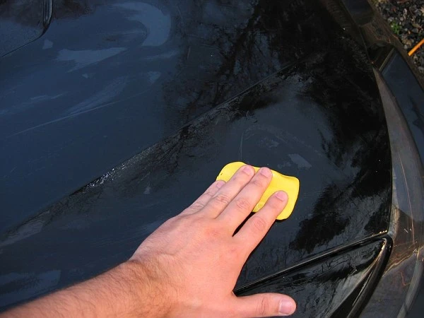

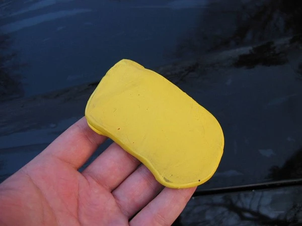

Claying...
continued...

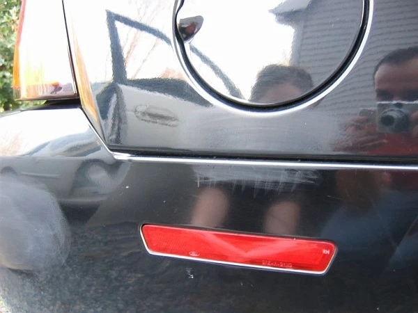

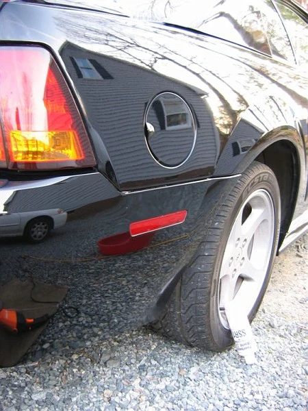

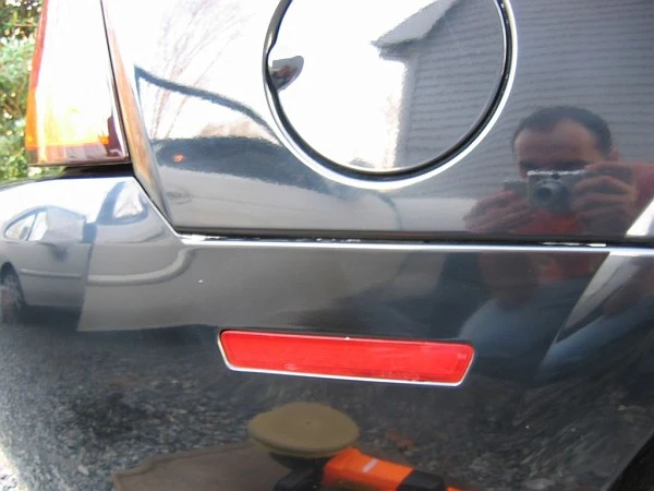

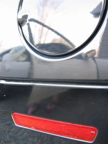

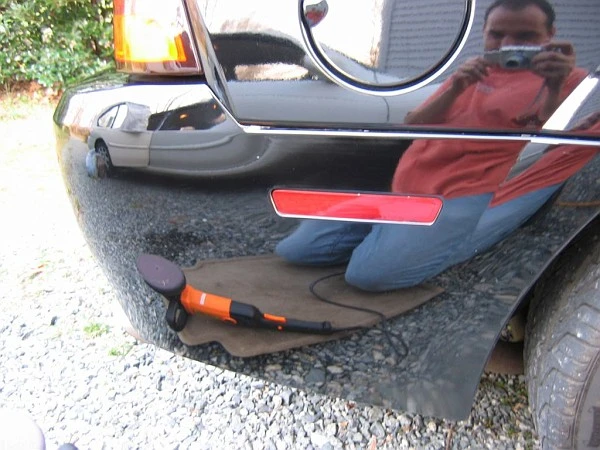

I wet sanded problem areas with 2000 grit.
I've seen these kinds of scratches in most cars because of the gas cap dangling on the paint.
WET SAND!!
Compound!
POLISH IT!

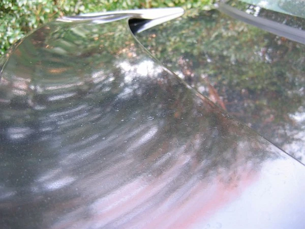

I also wet sanded the whole rear wing and trunk lid because there was some major water etching on it. Here's a time lapse video of that process:
http://www.youtube.com/watch?v=HI6aVcz_DwE

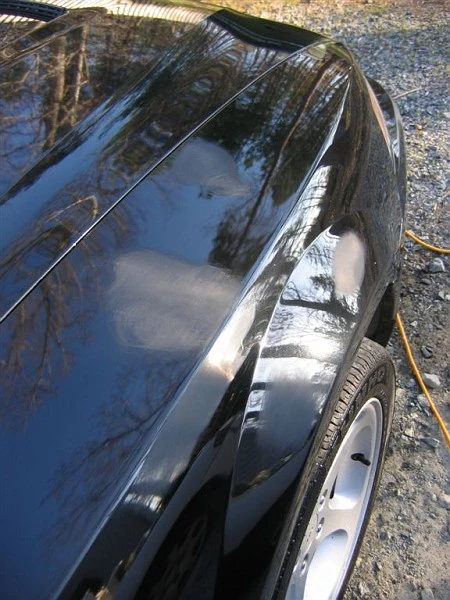

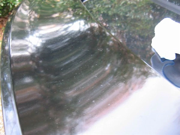

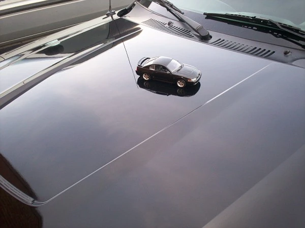

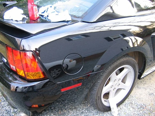

Here is what that rear wing looked like before the wet sanding and polishing:

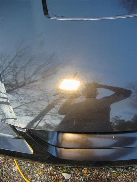

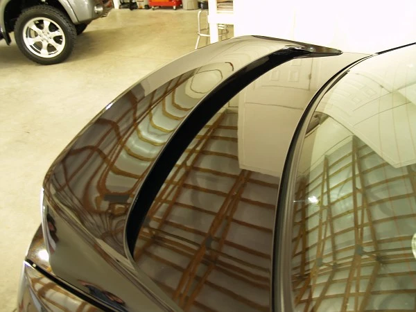

And here's what it looked like after the whole deal...

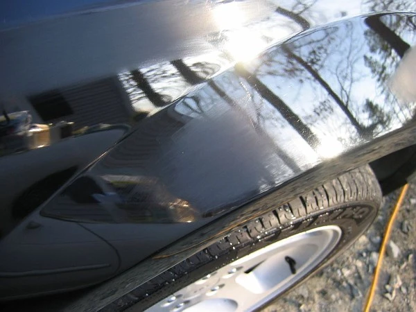

And finally, some misc. afters:

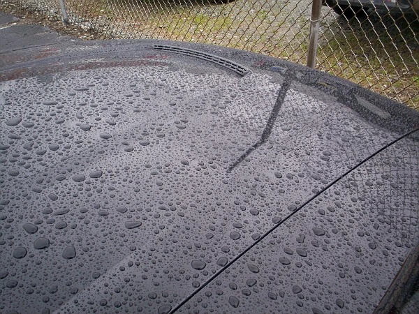

And a nice water beading shot after the detail...

wytstang said:
I see you used PB SSR do you find that it dust up quit a bit? I stopped using it and moved to Opt compound and polish. Dust almost non for me using the Edge 2000 set up.
It does dust up a little on a rotary but not on a DA (I used both a PC and a cyclo). But even on a rotary I like to mist my pads with one or two sprays of pad conditioner or QD'er before each pass which helps with that.

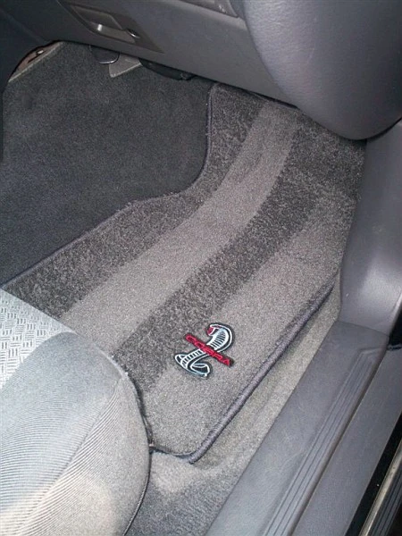

Finished the job up by steam/extracting the interior with an Oreck Steamer.
Sorry about the nasty clutch pedal... I'm about to replace it with the same as the other ones.

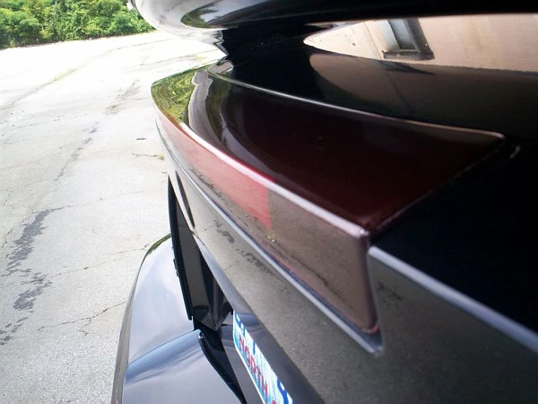

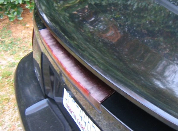

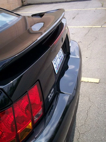

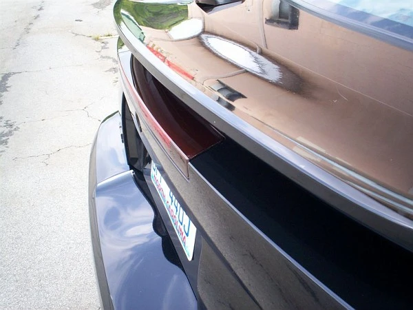

This is some before and after for probably one of the most common problem areas of this style mustang... the rear third brake light lense. I don't know if I've seen a mustang this style without a crapped out lense. I guess it is the material.
Process:
  • Wet sand with 400 grit
  • Wet sand with 1000 grit
  • Wet sand with 2000 grit
  • Polish with ScratchX on a LC orange pad on rotary at about 1,200 rpm
Before:
After:
