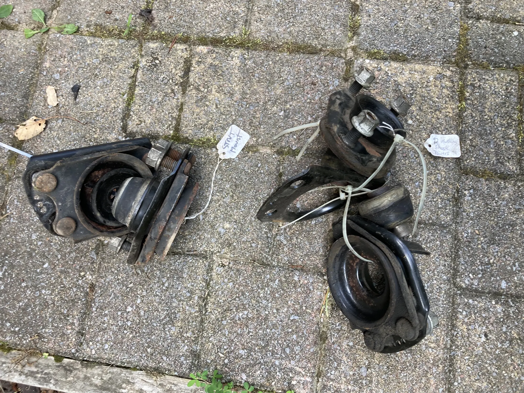

I’m glad I’ve gotten a somewhat organized in the last few years because I rarely throw car parts away. Took me about 3 minutes to find my original strut mounts. I’m looking forward to putting these back on to see if it shuts the clunking up.

The first thing I’ll do is put the factory mounts back in (unmodified) and see how it aligns. If I can get the camber right with the factory mounts, I’ll give the caster setting (whatever it happens to be) a try and see if I can tell a difference from raked back position its in now. I mean, right now in the UPR plates the top of the strut is pulled as far back as possible. So if the factory mounts move them forward again, maybe ill know a driving difference, maybe not
I took the UPR camber plates out and put the factory strut mounts back in. I set the rivet in the same position as the factory had it which is as far positive as possible in the factory holes. I measured camber at about 1.5 degrees negative. I think the fact my front end is lowered a bit won’t let the camber come in spec with the factory limits. I’m going to buy the camber adjustment bolts and bring the setting as close to zero as I can and then I’ll reset the toe setting if necessary.
The great news for me is the clunking is gone. It’s factory strut mounts for me, indefinitely

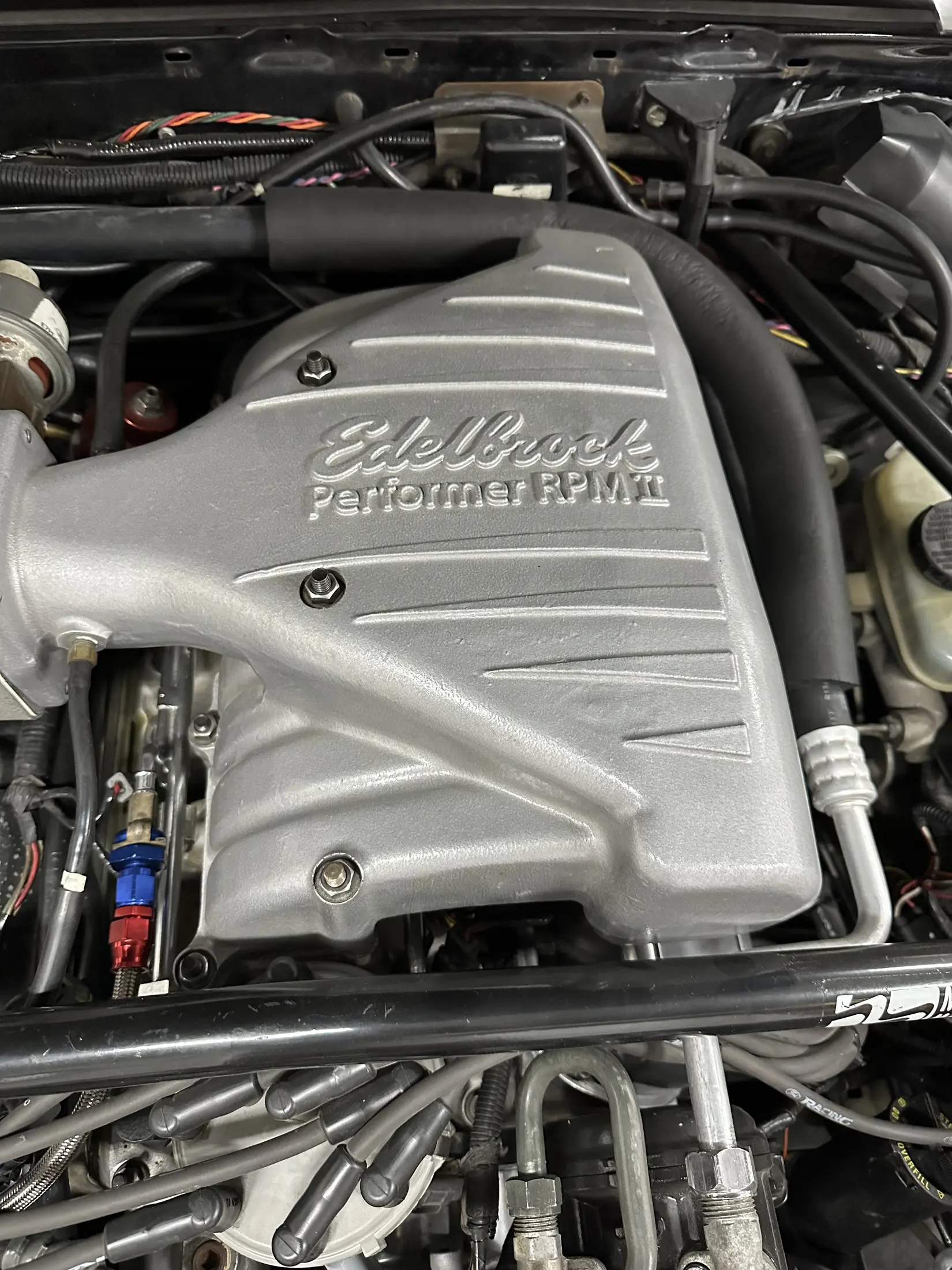

You guys ever notice how the stock upper intake bolts don’t go into the lower very far and thus risk stripping the aluminum threads? Well started having that problem but here’s what I did.
For the front and back shorter bolts I made a stud to install in the lower. Nice and deep and way past the boogered part. The studs also help tremendously for guidance when installing the upper.

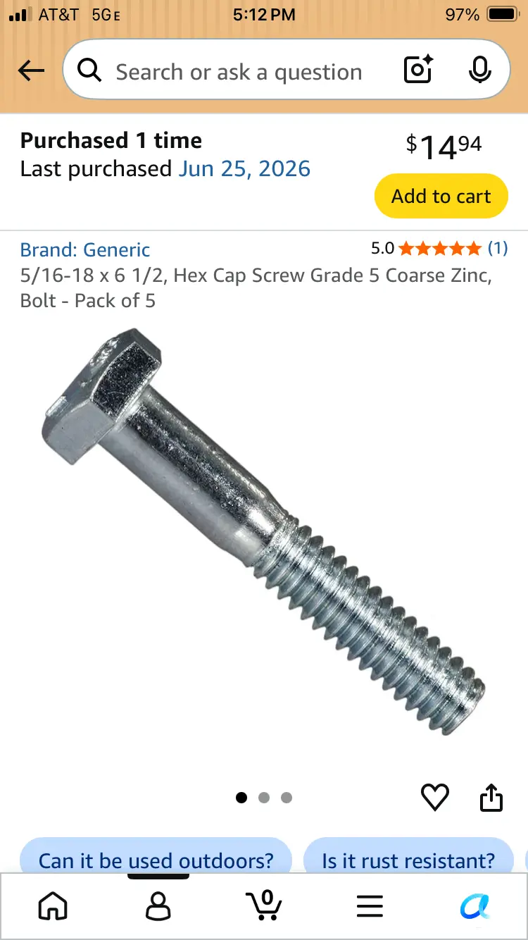

For the other 4 longer bolts I got grade 5 replacements. They’re 6 1/2” long and reach into the lower threads much better. A flat washers will be needed for these. Got them on Amazon. Took me a while to track them down at a decent price.
In case anyone wants them, maybe this will save you some time.
