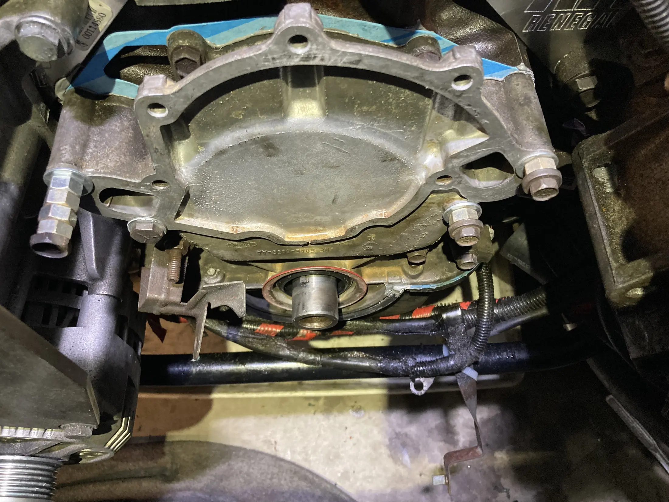

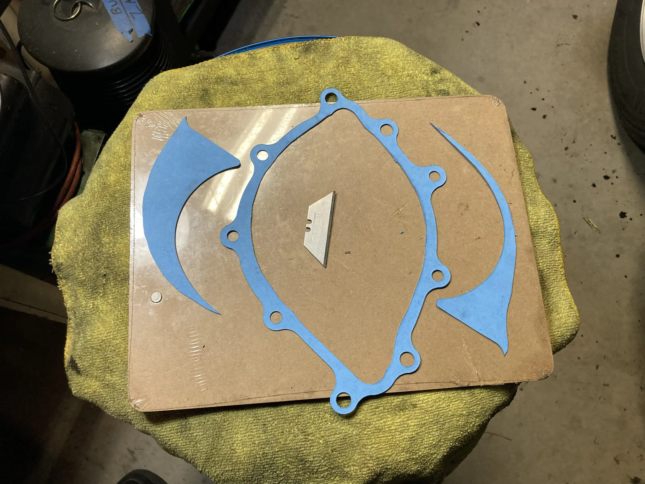

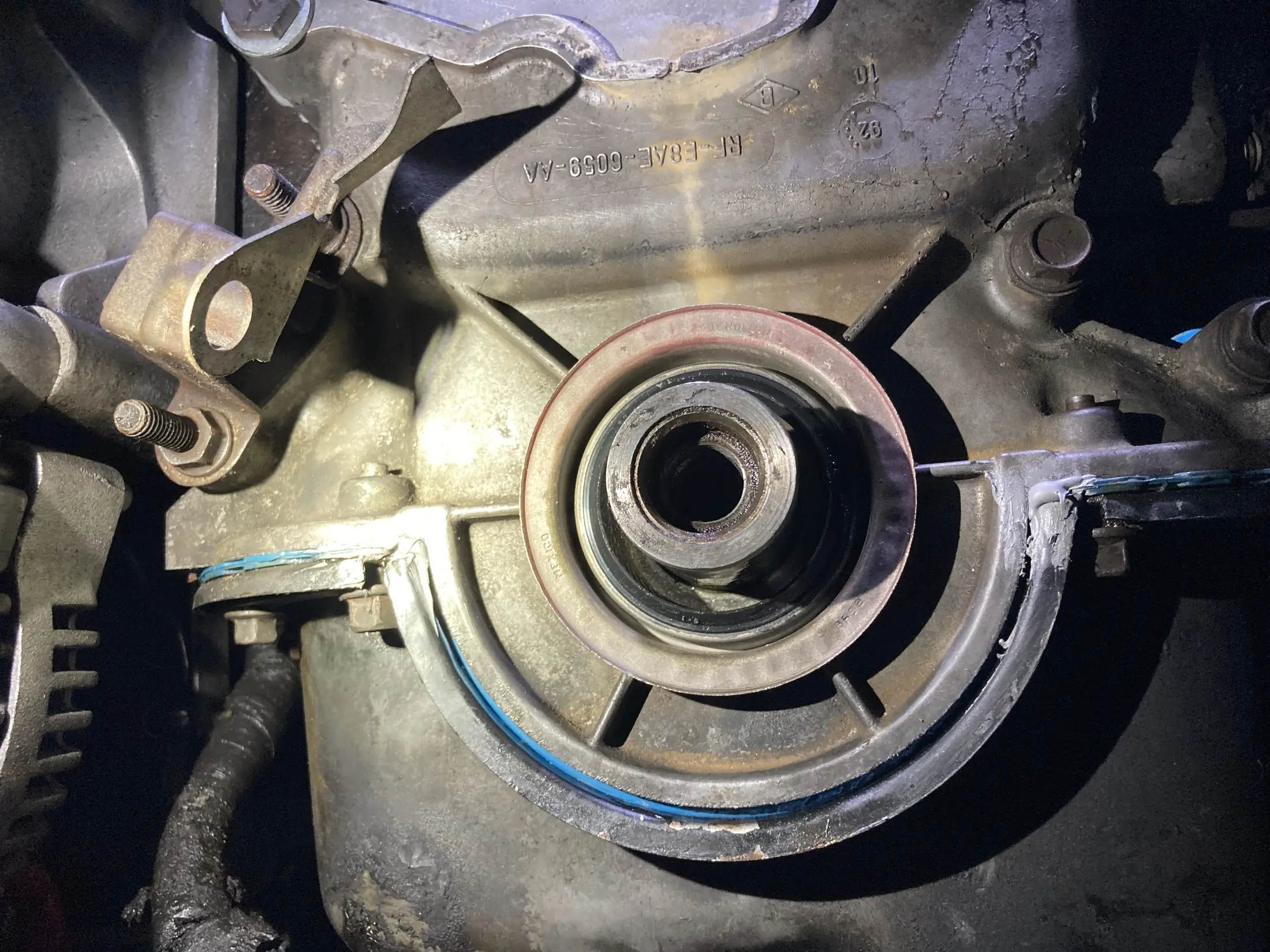

Ok I got the timing cover bolted in with substitute bolts for missing water pump situation. I’m going to let this set for 24h minimum before I put the pump on.

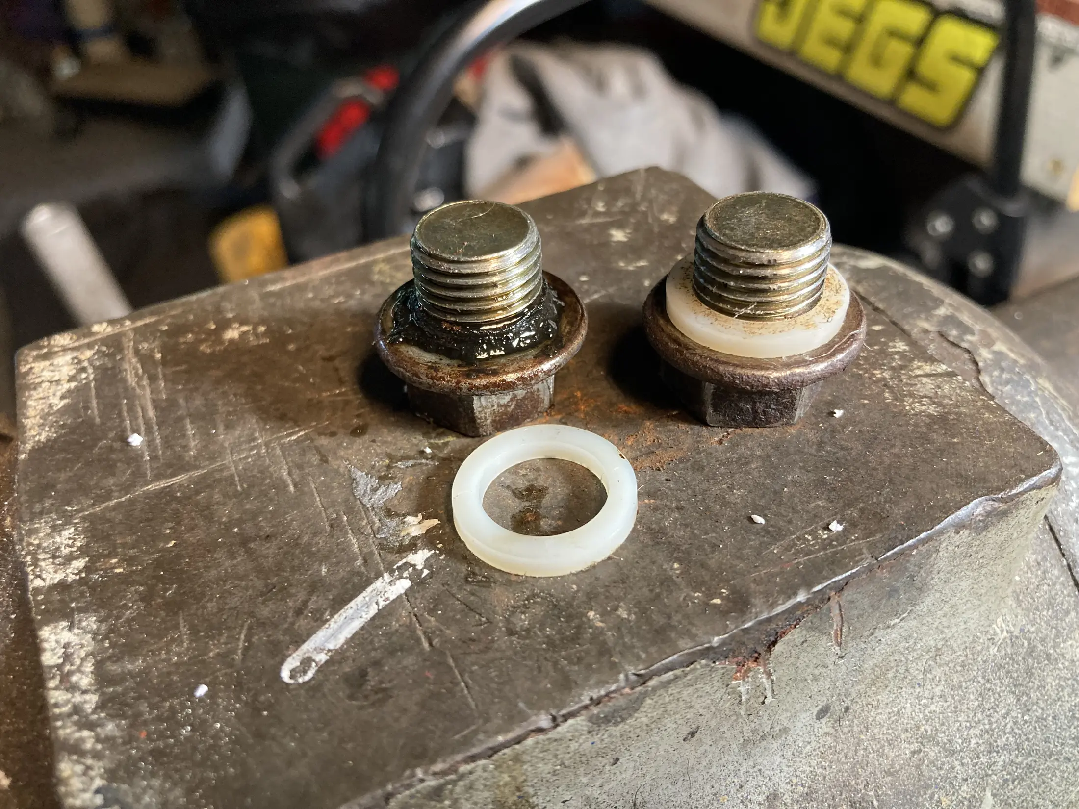

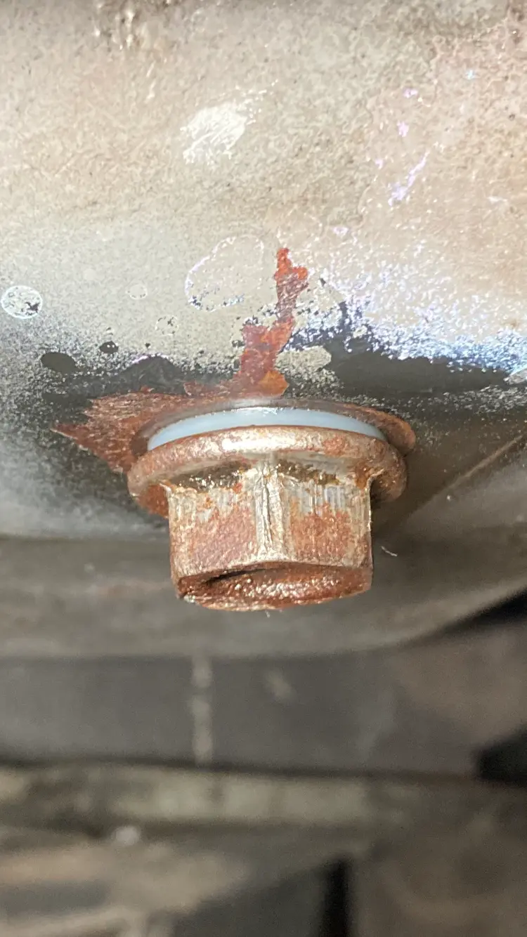

Gonna change the oil and filter before I start it up. I heard on another site somewhere that Wix filters have declined in quality so I’m removing the Wix and putting on Carquest Premium filter. I also got these nylon drain bolt gaskets for 79 cents at Napa. They’re a tight fit and had to be driven down over the threads with a 14mm deep well socket.
The number on the Napa receipt is 174-1965

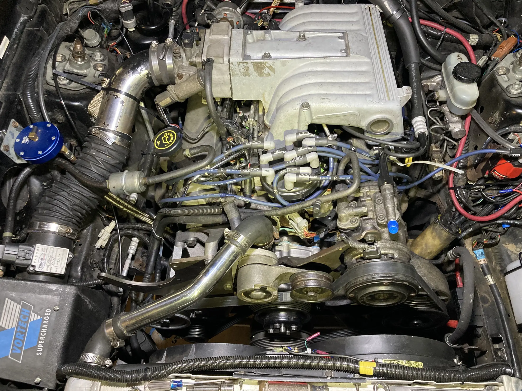

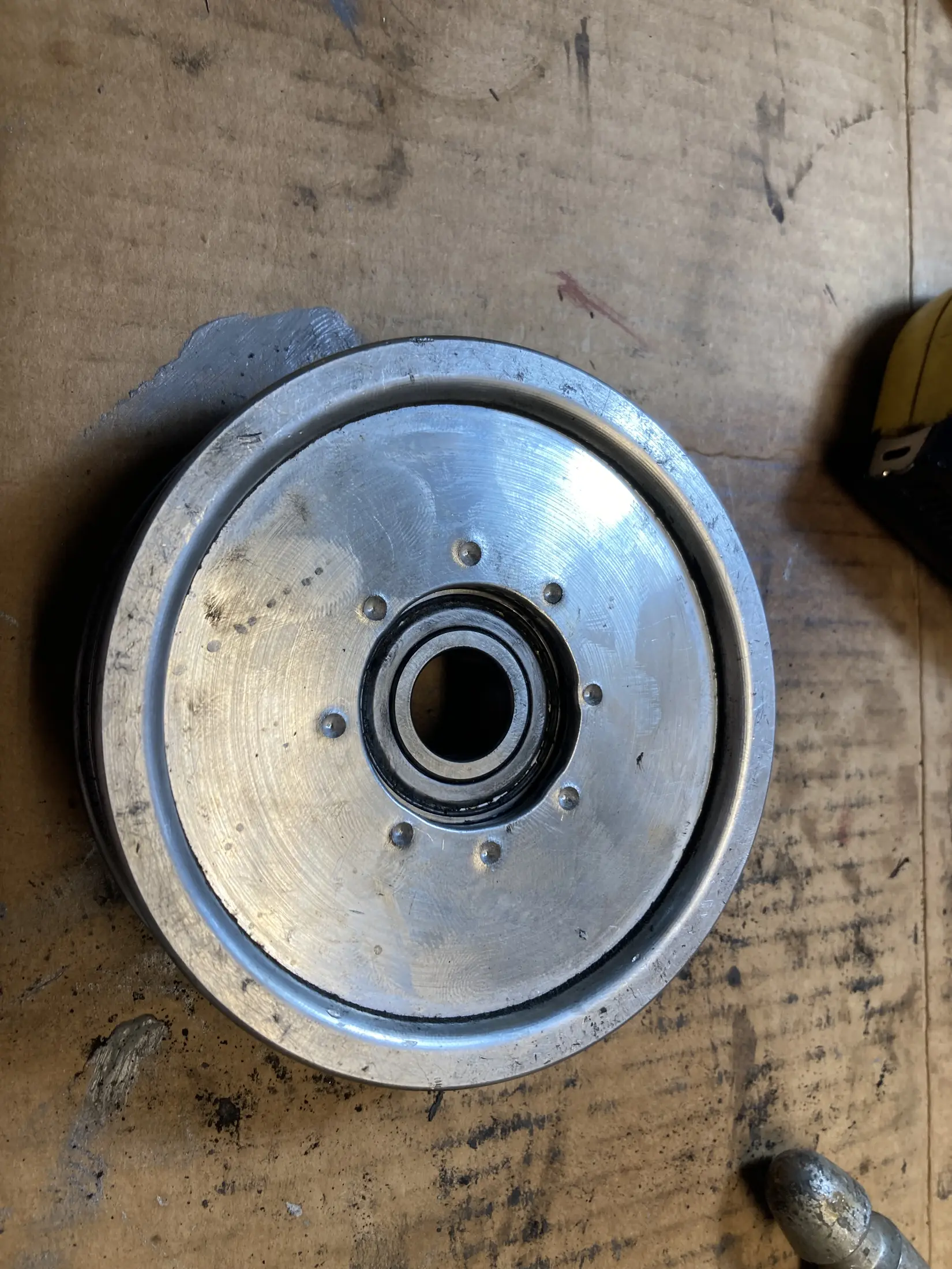

Got a slight intermittent rattle somewhere on the front of the engine. Maybe a missing or loose accessory bolt. I’ll update when I track it down
The rattle was coming from the smog pump delete pulley. I had an issue with a loose bearing previously. Well, it came back. The hole in the pulley is actually slightly too large for the bearing and allows the bearing to move withing the pulley ever so slightly. I think I rigged a fix, at least a temporary one. Anyway, the bearing is tight in the pulley bore and it's not rattling anymore. I fixed it by dinging the pulley metal with a center punch. It shrunk the bore just enough and now the bearing cant move within the bore. Its quiet now.
After more running of the car, especially getting it really heated up by spirited driving, the valve train rocker arms got a little noisy. They would be perfectly quiet like they should be on cold start up but after heating the engine up really good they would start ticking at idle. Only one or two of them would tick but this kinda thing drives me crazy. I did a bit of research and discovered how the aluminum heads can expand quite a bit when heated up and this expansion of the head can reduce the set lifter preload. On initial assembly I had used .020 pedestal shims to set the lifter preload to an average of 1/2 to 3/4 turn from zero lash to torqued down. Well, to address this "hot ticking", I went back in and remove all of the .020 shims to increase the lifter preload. With them removed I'm averaging 1 to 1.25 turn to tq from zero lash. I'm delighted to report that this fixed the "hot ticking". It's quiet now even when heated up really good. Feels like it may be a tad more powerful now too. Who knows, maybe I was leaving a tiny bit a valve lift on the table when it was ticking. Its not ticking anymore and running fantastic!
