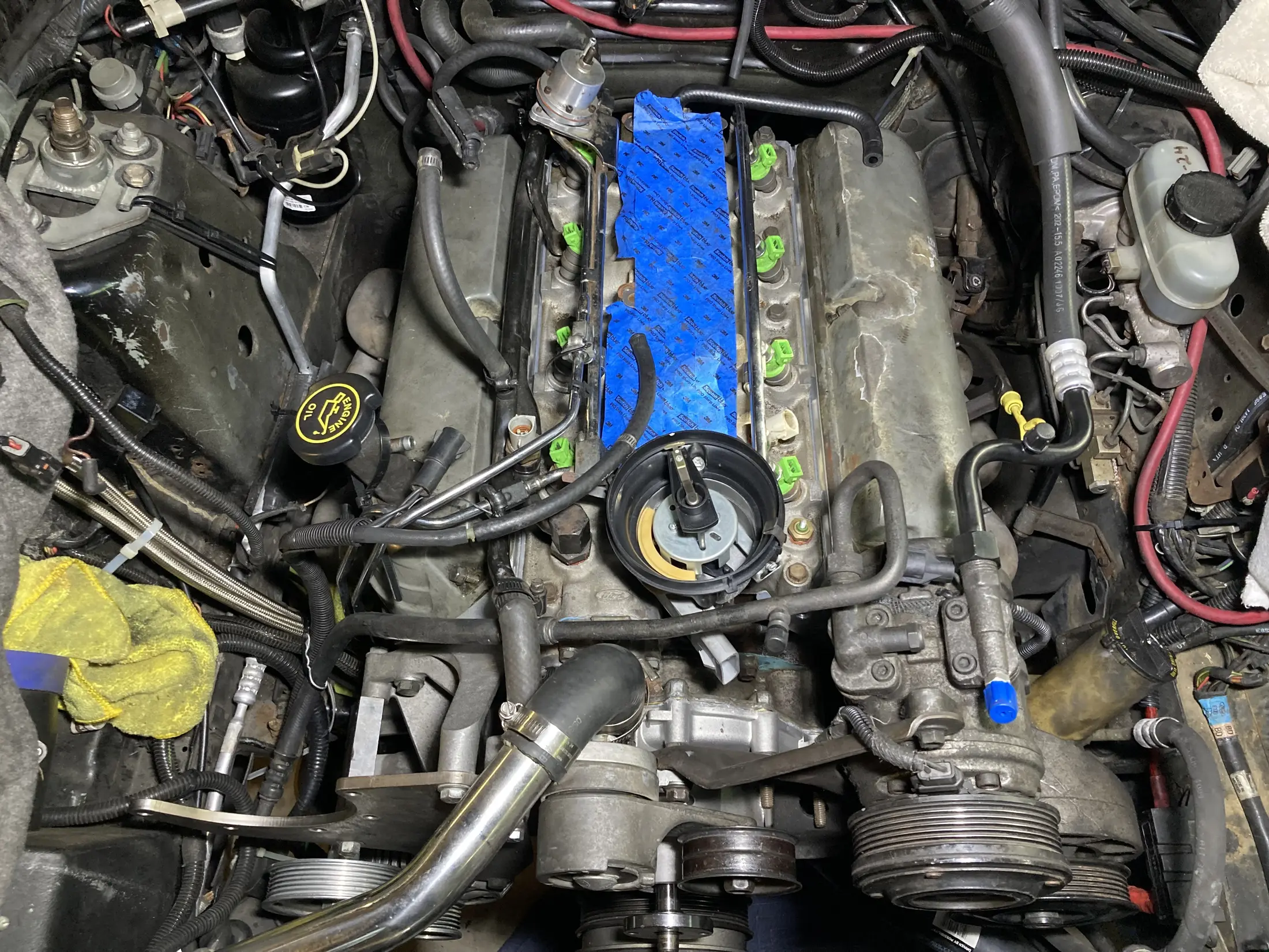

Obviously you can see the air pipe going straight from the MAF to the TB. I’m going to run it NA for a little while before putting the blower back online. Probably do that in the fall.
I’m really glad I re-torqued the lower intake bolts. Remember when I initially did them I only put a small bit of wd40 on the threads. These’d bolts were already loose after the first heat cycle. 3 or 4 I could practically remove with my fingers. This time I put anti-seize on the threads and took them to 18ft/lbs. they’re good and snug now.
Got a slight intermittent rattle somewhere on the front of the engine. Maybe a missing or loose accessory bolt. I’ll update when I track it down

Air intake pipe was knocking against the shock tower and there was a couple of compressor bolts needed some extra snugging. I don’t hear the rattle anymore.

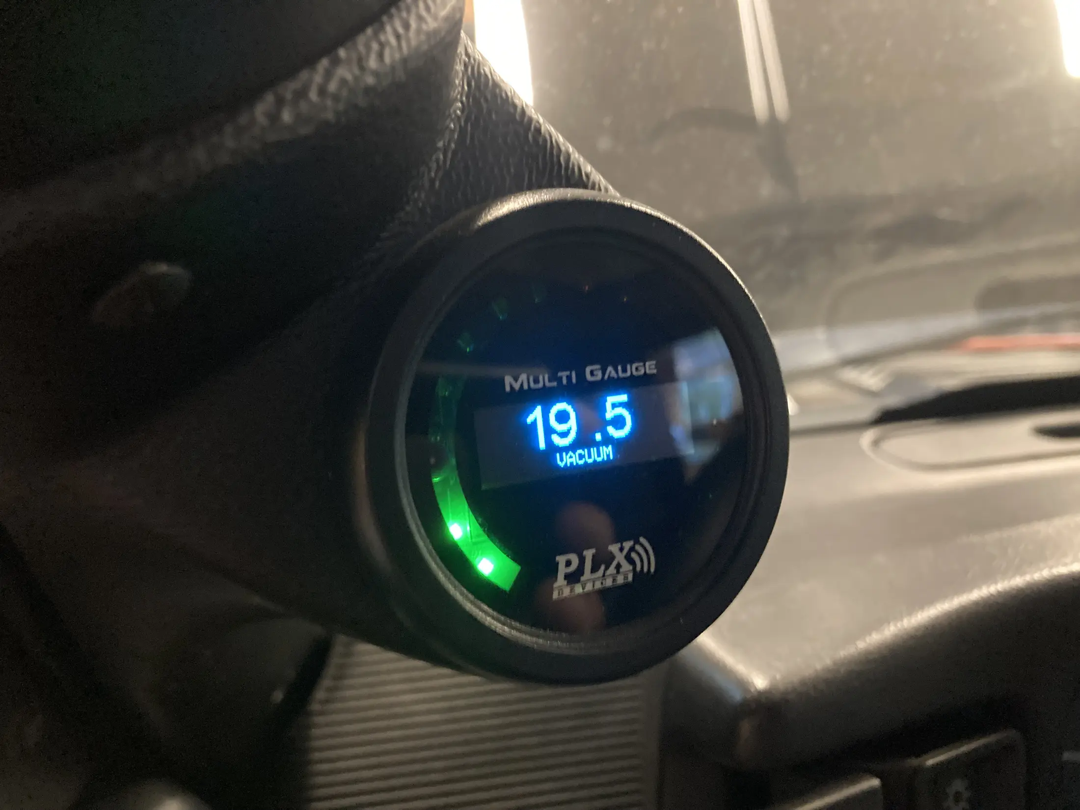

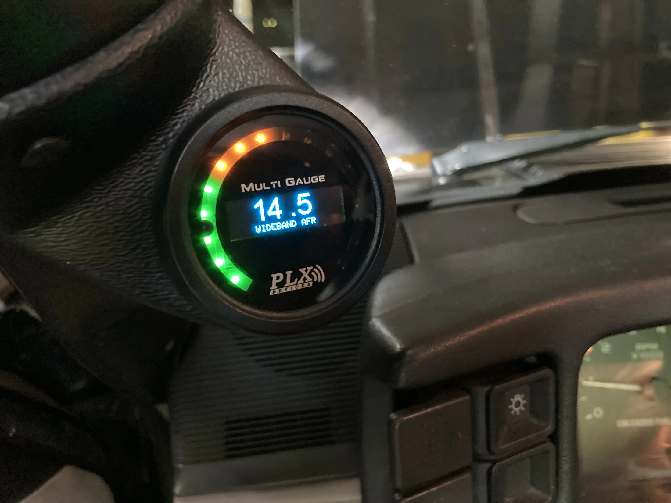

Here’s the A/F ratio at idle, FP 39psi vac off, timing 10 degrees spout out.

Can PLX make me a white-faced analog version of your multi-gauge with an amber backlight?
kthx :jester:
Mine is one of the earlier ones. If anything else is available I suppose they would list it at their website. I’ve got no complaints about PLX. Still working great for me
On my PLX I currently have vac/boost and AF. I just learned they have a fuel pressure module I can add to the chain. They didn’t have that before as I can remember. Be nice to have that available on demand.
