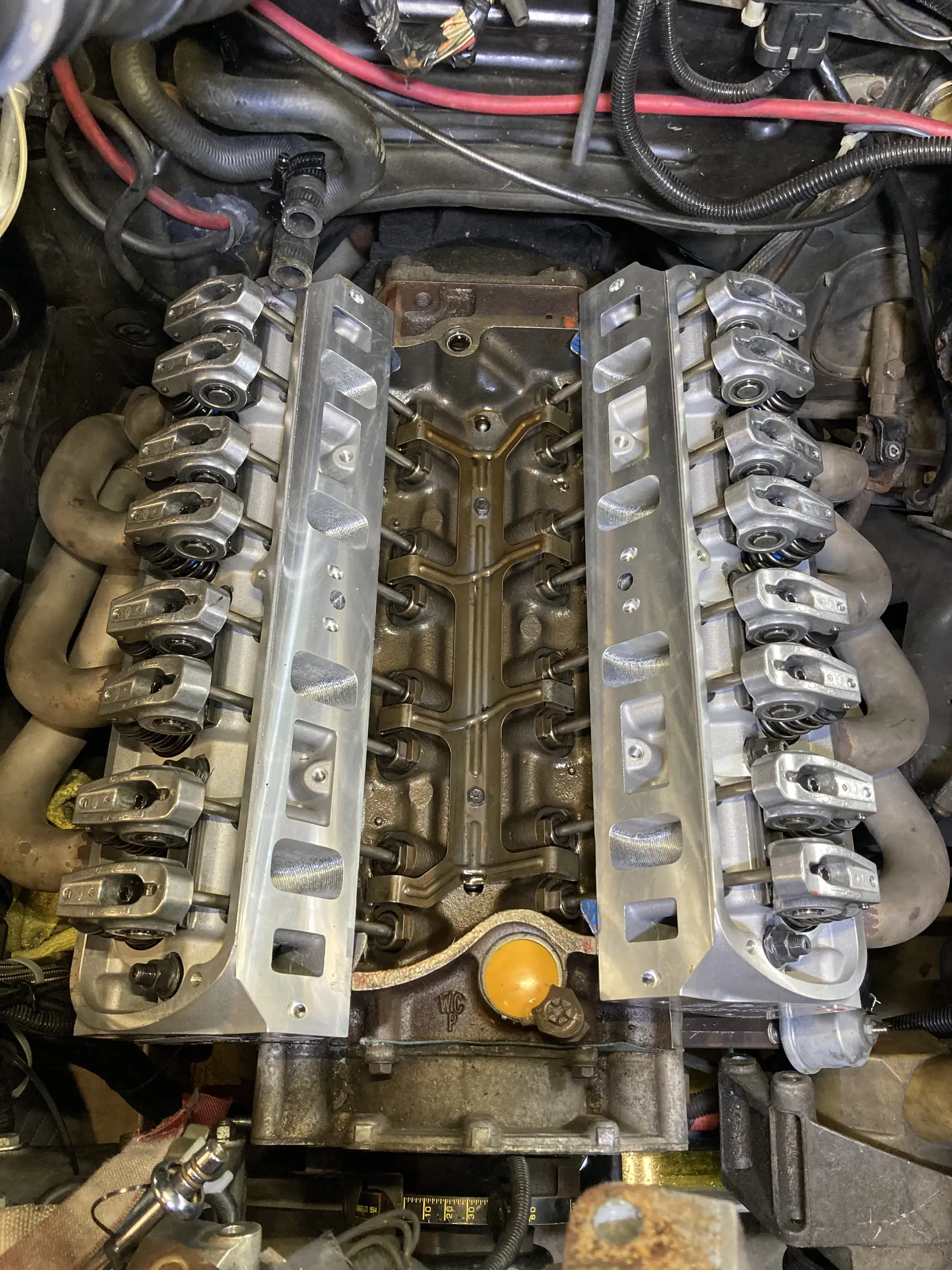

I’m shimming pedestal rockers. I have stock forged piston in this 302. According to Airflow Research, the AFR 165 Renegade pedestal style heads are the only AFR heads that work with stock pistons.
I understand , just so you know TFS twisted wedge heads work with the stock pistons to but that’s not the convo here. Especially with a stock cam.
I had those same rockers years ago they are the same as 93 cobra rockers.
All the shims end up realistically doing is making up for pushrod length. If they were right length the pre load would come in correct with no shim.
Either way , can’t wait to see it all buttoned up and running good for you again !
Reactions: JD1964
.020 shims give me 1/2 to 5/8 turns preload on cylinder #1. I’m going to rotate the engine 90 degrees at a time and follow the firing order to continue with .020 and see what happens
Reactions: TOOLOW91
Heads are on and torqued. Headers on. Valve train on with .020 shims in each position getting 5/8 to 3/4 turn to cinched in all positions. Next I’m going to put the exhaust and o2’s back on underneath and then to water pump.

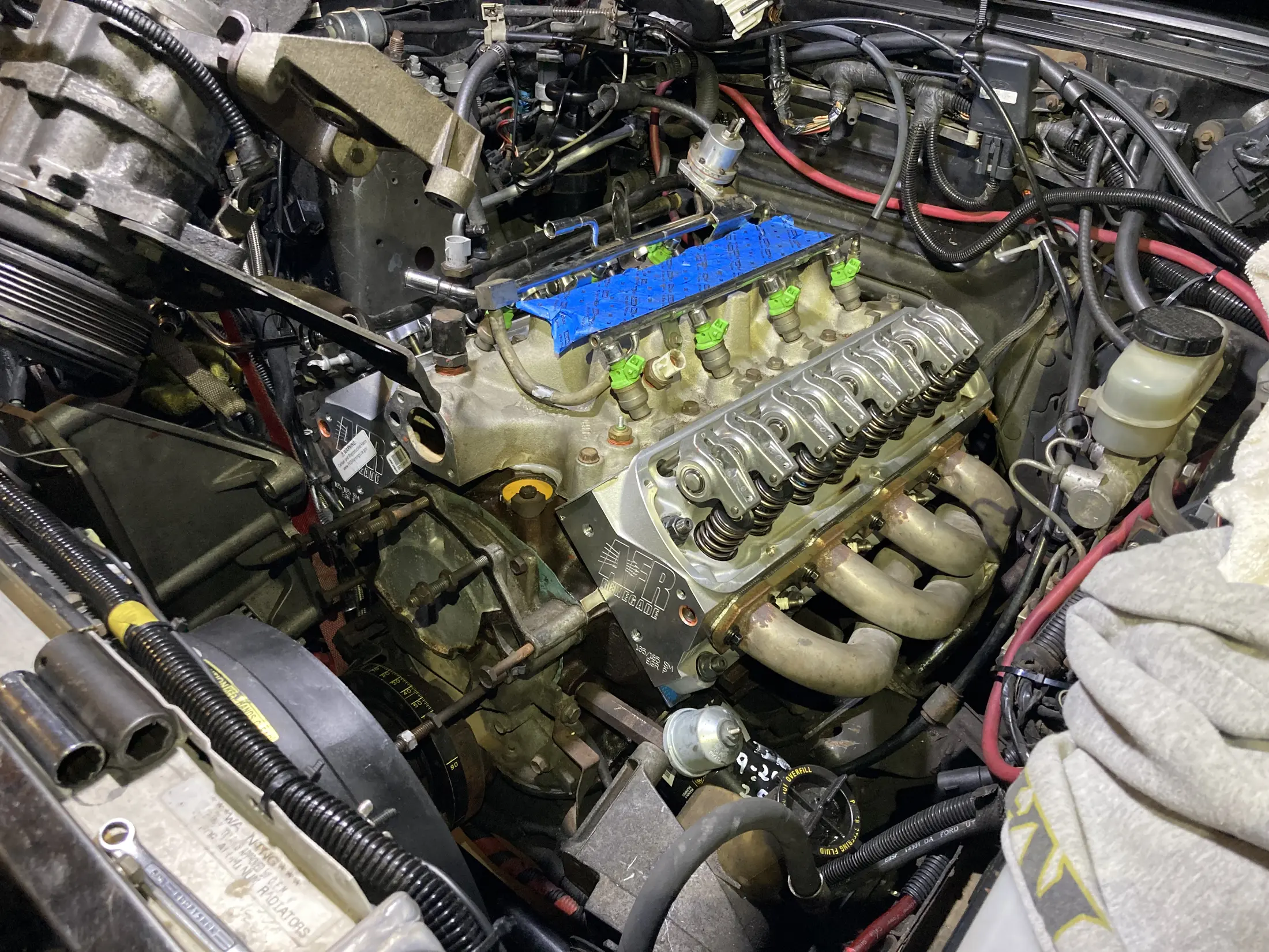

I got the exhaust back and o2’s back on underneath, gapped a new set of 3924’s at .035” and put them in.

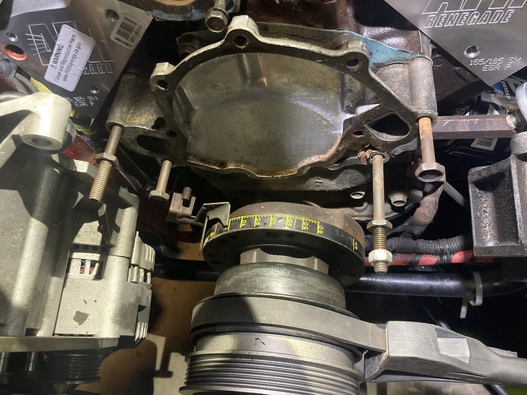

Which ones of these water pump mount bolt holes extends into the water jacket?
So use some Permatex thread sealant on those four and anti-seize on the other ones.
I probed the bolt holes and for the life of me I couldnt confirm that they break through into the water jacket. I also searched the web and watched multiple videos and saw none where thread sealer was used on the bolt threads. I then found this from out old friend. So just to clarify, it looks like thread sealer is not needed on the bolt threads but anti seize is highly recommended on all of them.
