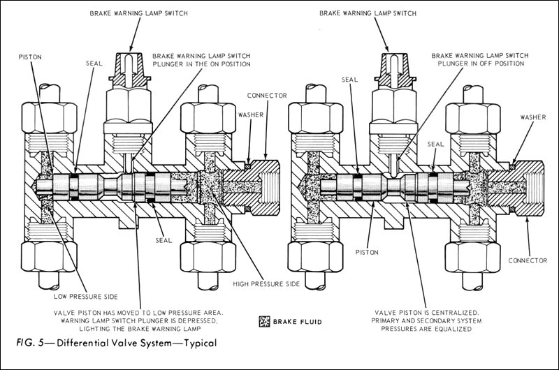

He's probably thinking too conventional, with a single divider block serving both halves, and a warning sensor in the middle. Pre-67 cars do not require the sensor, therefore do not require the single block.
This is what he expected to see:
