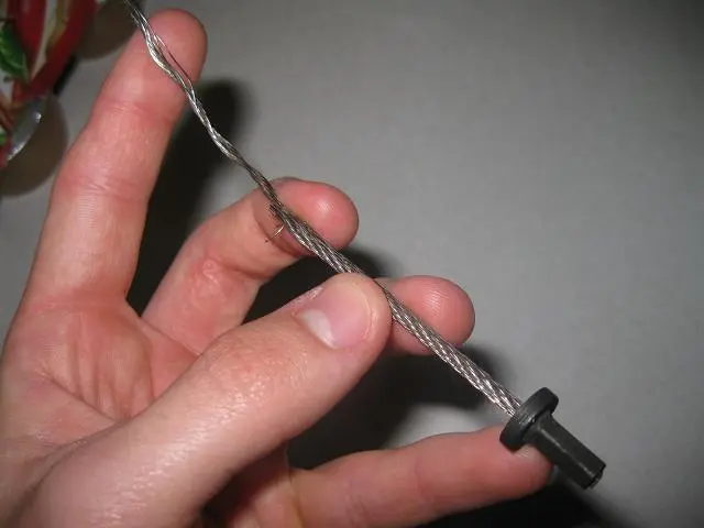

I checked under the dash like Hef advised and after maneuverer the quadrant back and forth a couple times in attempt to get a grasp of how things were put together under there, this literally fell into my hand:

I guess my next question is, how hard is it to replace a clutch cable? I have a guide in my all encompassing "fix your mustang" book but it's fairly limited. Anybody know of a good pictoral guide online? Does any one have any specific tips for the process in our cars?
Most importantly, will this be possible for me to do myself and without jacking up my car? It's at stock height and I think I can get under there somewhat. The car is on the side of a busy road in a parking spot so I wouldn't be able to jack it up.
I'm also wondering if there is a temporary fix, like a way I could attach something to the other end of the cable or temporarily mend it back together until I can get it home.

pretty simple, old one out, new one in.
if you get a quadrant while you're at it you may have to take the pedal assy out, again, easy, no smoke and mirrors to it.
from memory, get underneath and take off the clutch dust shield, should be a screw and a c-clip to remove around there, then pop the cable off the clutch fork. Somewhere along the cable housing (under the hood now)there should be a bracket with a bolt, remove the bolt, bracket will stay on the cable housing and a new one (mine did) will have a new bracket. There might be 1 sheet metal screw at the firewall to remove...since yours is broke, no need to un latch it from the pedal, just pull it on out. that should be removal. opposite for install...I put mine on the pedal side first then ran it to the clutch, and had to compress the clutch a bit to get it to mate up, a good c-clamp helped out there.
not trying to advertise for them or spend your money for you, but Maximum Motorsports has a nice quadrant, adjuster and cable as a package, price was right as well.
not sure there is a temp fix, but you can drive it clutchless, not the nicest thing you can do to your car, but you won't kill anything...I do that kinda stuff in the middle of the night. If you can get to a safe parking lot you're golden, easy enough to swap out right there. Just bring a jackstand and some basic tools...I always have a cooler of beer when I mess with my car as well.............I'm usually in my driveway though.

Update:
Got this in the mail:
Steeda Double Hook Clutch Quadrant and Clutch Adjustment Kit
It took me about 3 hours to install everything: quadrant, cable, and firewall adjuster. There were a few tricky parts but it seems to be running smoothly. The only thing I'm a little concerned with is the small squeak thats emitted each time I press the clutch completely to the floor. The rubber cable shield must be rubbing on something in the engine bay and I'm not sure what it might be. Anybody else ever had this happen after replacing a clutch cable?
Do you guys think it will go away after a while? :shrug:
