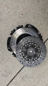

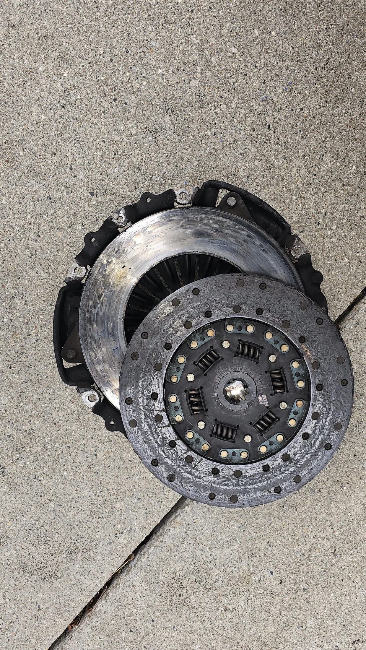

Without seeing firsthand, i'm leaning towards a clutch issue. I assume the cable didn't fail, but it would need to be something in the pressure plate. Regardless, if you decide to dig into this you'll need a new pressure plate, disk and throw-out bearing anyway, and inspect the clutch fork/cable for damage.
I don't think it's the trans, which is a T-45 Btw not a T5.
It [sounds] like the face of the throw out bearing has sawed/punched through the fingers of the pressure plate.
Is this even possible???? :scratch:
I'm leaning towards that too, it seems like a very real possibility, or it got worn down enough that the fingers were able to slip behind the throw out bearing, im starting to pull it this week, will upload pictures and solution when I figure it out.
