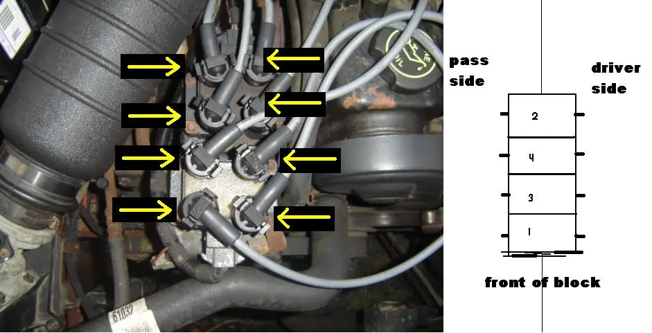

There is no arching. I also checked the injectors. Last are the spark plug wires in question. I attached a pic of the engine coils, just don't know which is which on the coil since they are NOT marked. I attahced a pic so someone can help me designate the proper order of plug wires to coil connector . Thanks guys I really need this car fixed by tomorrow :(

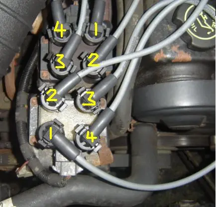

this is the plug to cylinder order in which my car is right now. Does it look correct? I know that in this foreum there are about 3 diff diagrams, but none match what I reaserched under my hoos today. Here is how thery are hooked up.
4 1
3 2
2 3
1 4
looking at the coilpacks standing in front of the engine and following each wire designate order.
DOes this look correct?

4 1
3 2
2 3
1 4
