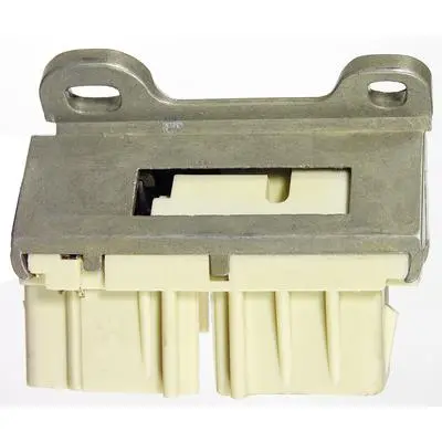

Check the ignition switch. Overtime they start to split and can give intermittent issues. Replacement is around $15 on LMR. Mine just had to be replaced

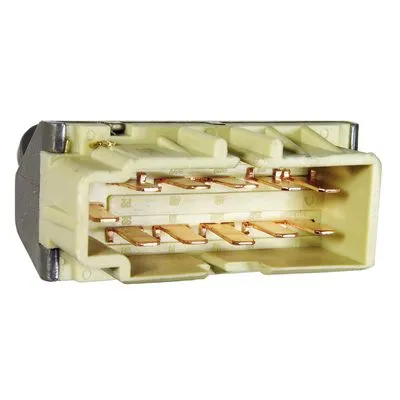

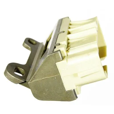

Another vote for replacing the ignition switch...
Recall on Ford Ignition switches:
Revised 7-June-2014 to add Torx bit picture and source. Also added replacement ignition switch wiring pigtail picture, part numbers and sources.
Some of the symptoms of ignition switch problems are things that don’t work or are intermittent like radio, turn signals, wipers or heater.
There was a FREE recall on Ford ignition switches. They overheat and sometimes catch fire. That burns up the steering column and sometimes the car interior. Since this is very old information, you may not be able to get the switch replaced for free anymore. The auto parts stores sell the switches for $13-$15.
While you are working on the switch, check the wiring and connector closely. A replacement connector with new wiring pigtails is available from most auto parts stores
AutoZone and Advanced Auto Parts have the same Part Number: 434 - may have to order, not always in stock
Advanced Auto Parts alternate part number: PT5534
Saleen0679 was nice enough to dig this up for us awhile back: Replace a 1979-1993 Ignition Switch Assembly
Torx bit set from Advance Auto Parts

Thank you for the suggestions. Changed the switch tonight. Rain for next 5 days so won't be able to test it out but the switch positions feel much more solid now. Fingers crossed this was the issue.

Well. That didn't work. It actually got worse but I can get it to kill with rotating the key back just a bit. Zero rpm on tac when it kills. Think maybe try new key switch next.

The zero RPM is because the power to both the tach and the ignition shut off. Look closely at the switch wiring connectors for evidence of heat damage.
