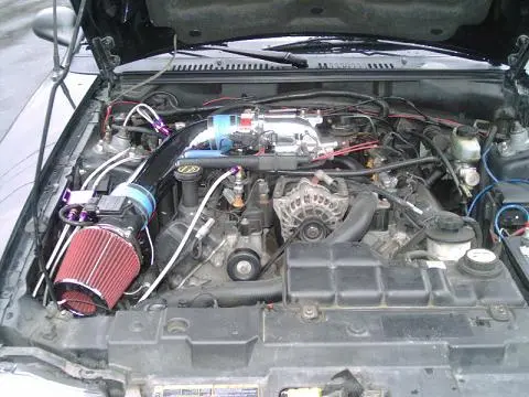

Well i cut the mac cold air intake to a short ram, friends keep telling me it was a bad move, so was this truely a bad idea or are they a little special, I know cold air helps but its really not gonna be a big difference.
here is a pic

hey! i have that intake. i dont know what exactly the problems are with the mac that make people hate it so much on here and other boards, but i'm sure most people will say that cutting it up like wont hurt anything with it :) doesnt look to bad actually.

I don't understand - do you mean it was an 'in the fender' setup and you removed the fender part? I think that is a wise idea - a turn before the MAF can cause inaccurate MAF readings. The straight flow setup you have now is optimal. And when the car is moving, the air temp pulled thru the tube is not going to be much different than what you'll pull out of the fender. At a standstill, sure it'll pull warmer air...but who wants to standstill? :D

yes it was in the fender, I cute the pipe back. its gonna be mainly for track racing anyways. so i will also be able to take out the headlight. the car is going in for tuning once i get my cams, and heads
If you're going to keep that setup, at least consider getting some stuff from Home Depot and get a little creative and fab up some sort of heat shield for it. Maybe something similar to the K&N FIPK. It shouldn't be hard at all.
