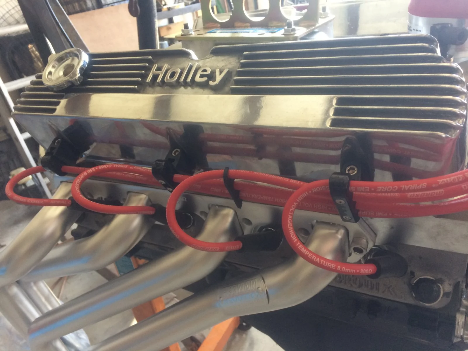

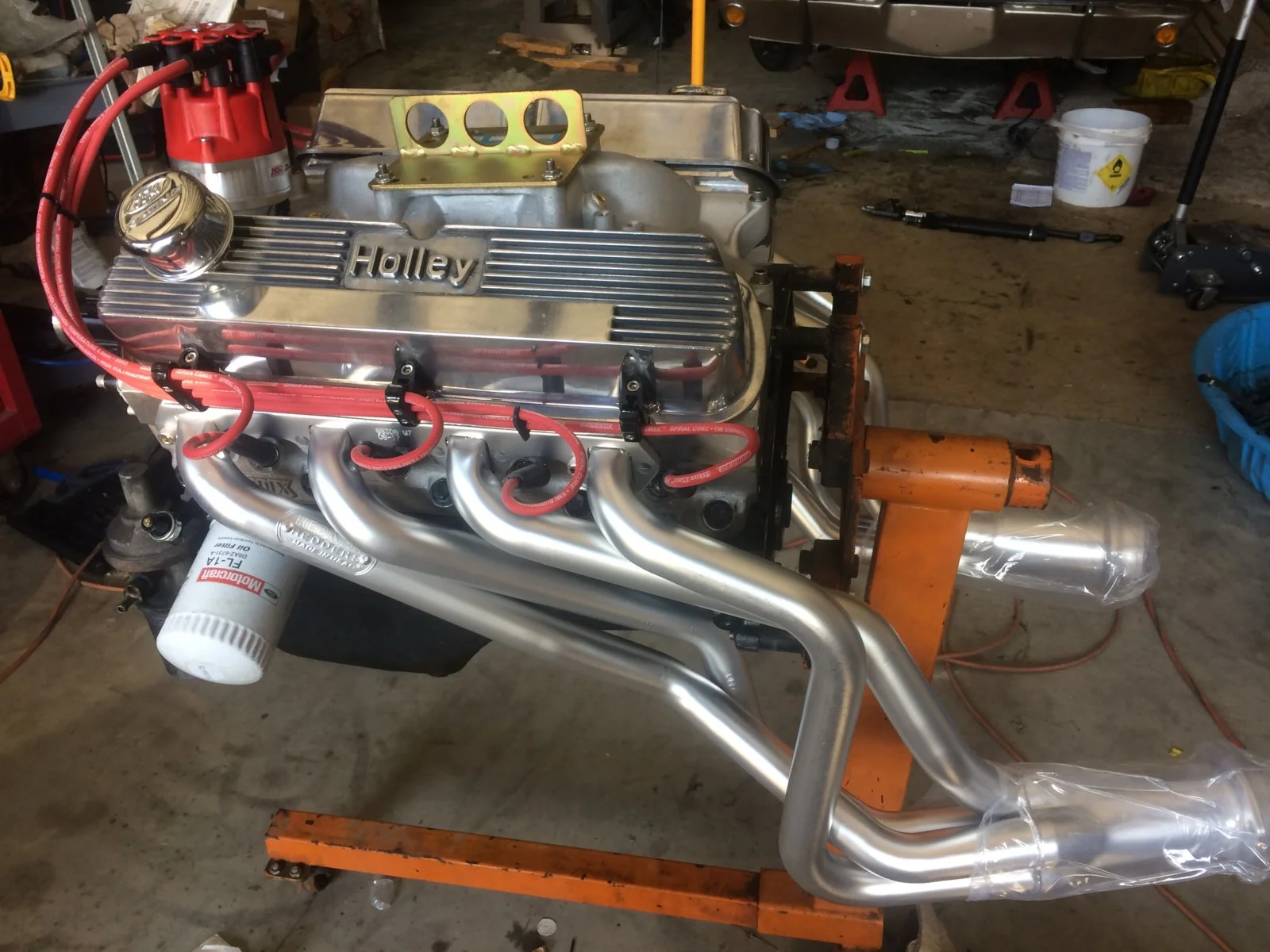

Check out the Brodix ST5.0 heads from summit. Damn these are nice heads!!! About $1200 for pair and they are READY!
Have them on a 65 289. Love them.
