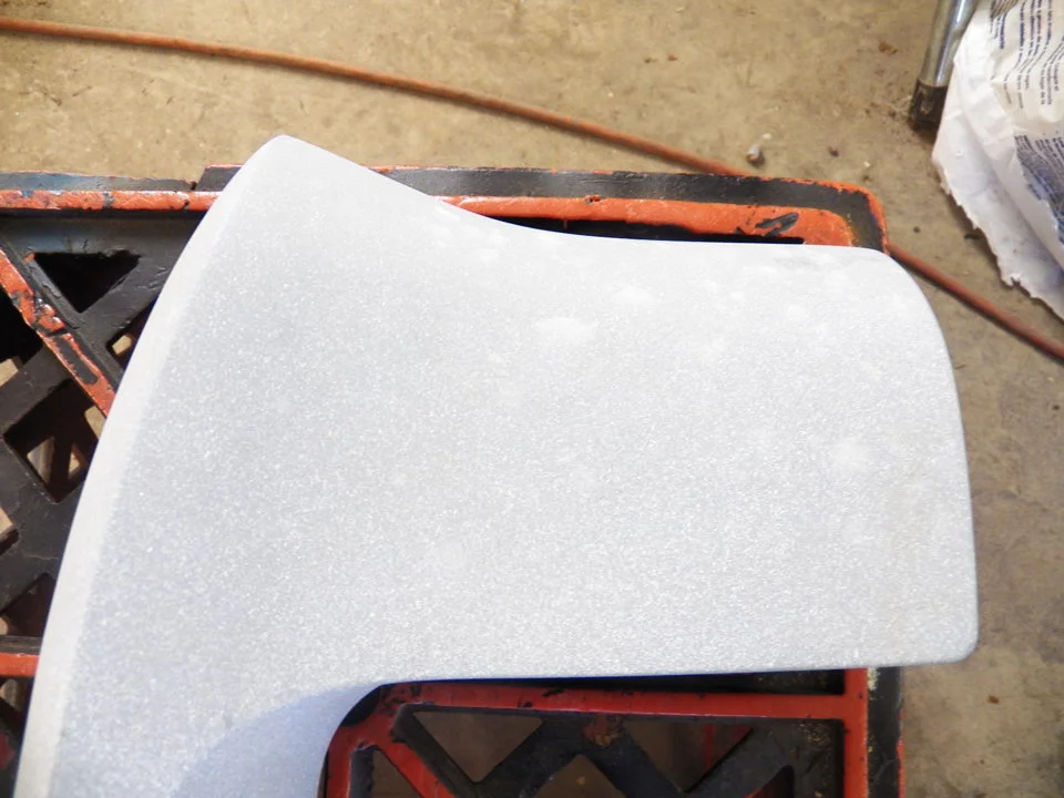

Ok ,i know the difference in the tail light panel area .Is there a difference in the shape of the end caps and end of the quarter as well? Will a 70 end cap line up with the edges of a 69 quarter ? I have worked on 69s but never a 70 convert .
Here is a pic of a 69 convert quarter end ,does anyone have a pic of a 70 quarter end ? Is there a difference in the top line at the end by the caps?

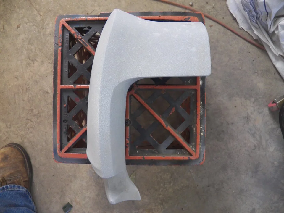

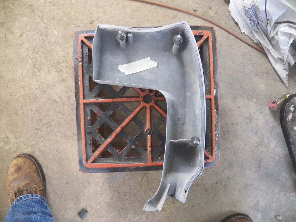

this is a 69 convert end cap, the point at the top is sharp and high .I can't find a stock 70 end cap but the top point is blunt and lower than the 69 .If you were to put a 70 end cap on a 69 body the quarter would stick up above the 70 end cap at the top point ,and the mounting studs are completely different .I have done a few Shelby replicas ,all 69s but what i was trying to do was put the 69 end caps on an actual 70 body and they will not work.I have been trying to find a pic of a 70 end cap to show the difference but i can't find one .
