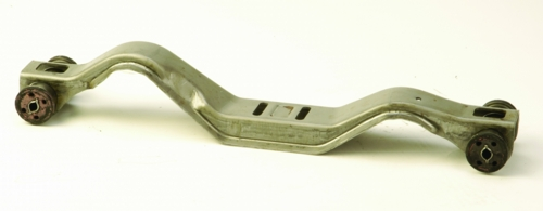

here's a v8 crossmember...
i couldnt find a pic of a 4 cyl one, but if you look under your car, you'll see it only has one of those humps
