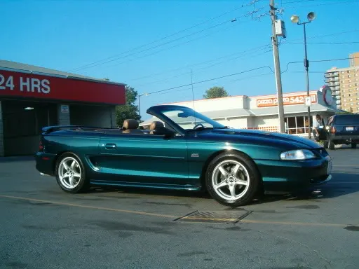

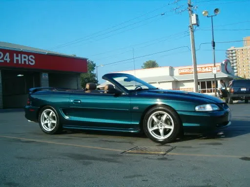

I've got 17x8 '98 cobra's on mine with 275/40's in the rear and 255/45's in the front. The ideal size, as everyone just mentionned, is to go 245/45 in the front to have the same height as the 275's, but I went with 255/45's in the front since for some reason they were almost $100 cheaper, and they're only (IIRC) 0.3" taller. There's nothing wrong with the fitment and they look fine. I wouldn't try to fit a 285 on there though. Get a 9" wheel for that.
Pic whoaring time :D
