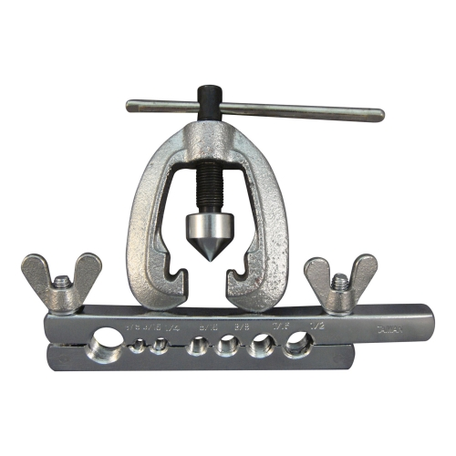

jrichker StangNet's favorite TOOL In Remembrance. Thank you for your contributions Mar 10, 2000 27,512 2,813 234 Dublin GA May 18, 2012 #2 May 18, 2012 #2 Try clamping the tube with the block from a flairing tool. Once you have the tube clamped near the ridge that limits how far in will go into the block, you can tap on the flairing tool block and seat the tube in place.
