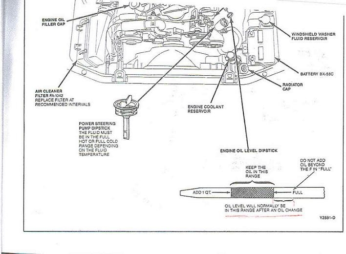

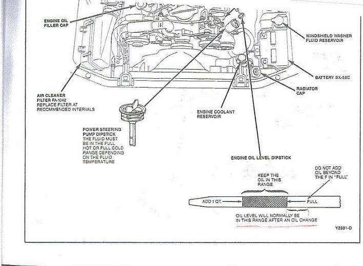

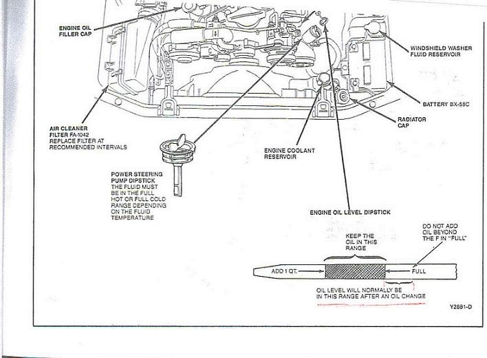

Make sure you drained from both plugs, and the Ford Service Manual says the level is safe up to the Letter "F" in Full.
