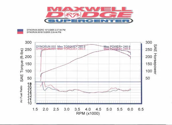

And I agree with everyone else here. An O/R X would help, but it wont make a huge difference. I was expecting atleast 260RWHP, but then i realized what I had against me....no airflowover the engine,sealed ram air hooked up, DD bullitts (66pounds per tire/wheel), and 3.73 gears. And on top of that my A/F was between 13.9 and 14.9 almost all the way. Here is my graph
So after taking all that into consideration, my #s are about right on.
For you, I would get a second opinion (another dyno), to make sure. 210 seems super low. Oh and take it to the track, and see what it runs. You could just have a lemon motor. :(
