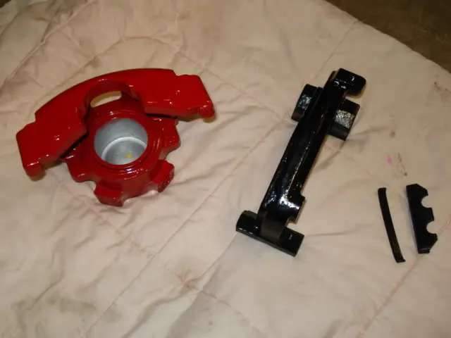

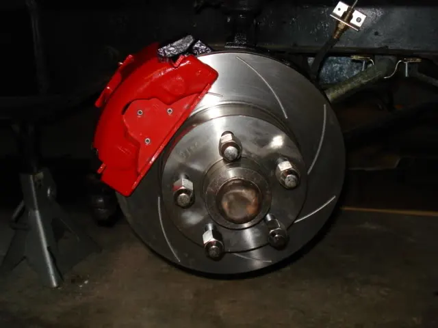

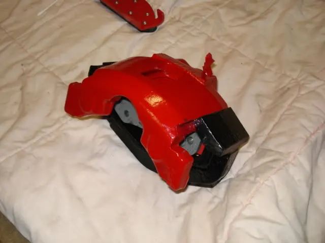

I just bought the slotted rotors from him :nice: I would have gotten the calipers too but I got those at autozone cheaper and without paying for shipping. Coincidenlty, I just painted them red this past weekend with high temp caliper paint. I'll post pics tonight!
