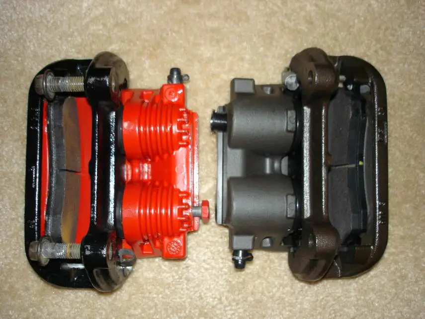

Assuming you used rear SN95 disks, the MC you should use depends on which Cobra calipers you installed.
94-98 with 38mm pistons = 94-95 Cobra 15/16" bore MC
99-04 Cobra/bullitt/Mach1 with 40mm pistons = 1993 Cobra 1" bore MC.
Best way to tell the difference between the Cobra calipers is to look at the underside of the piston bores. The 94-98 38mm calipers have ribbing on the bores, while the 99-04 versions are smooth.
38mm on left, 40mm on right

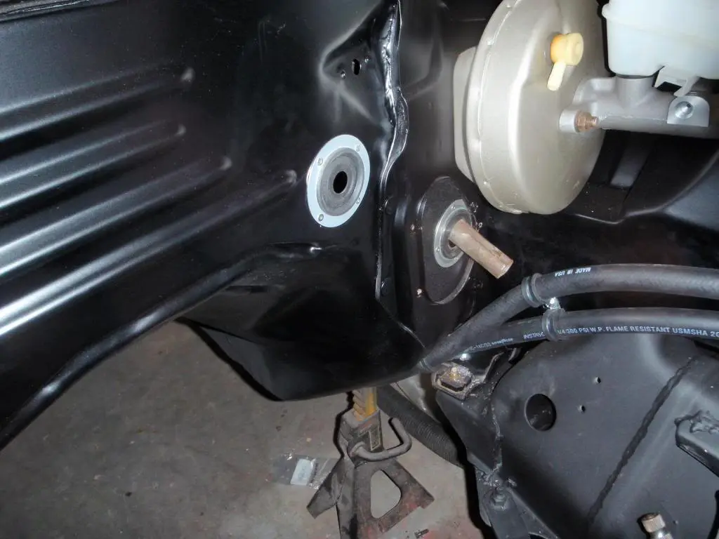

Hmmm,...not only is my booster stock w/ SN brakes all around,...It's the factory fairmont unit rated for the stock weanie disc/drum setup that came on the car in 78.
Firstly,...There is absolutely no detriment to the braking w/ this setup,...I have noticed nothing that I would remotely describe as marginal in the braking performance, and I have already stood on these brakes fairly hard.

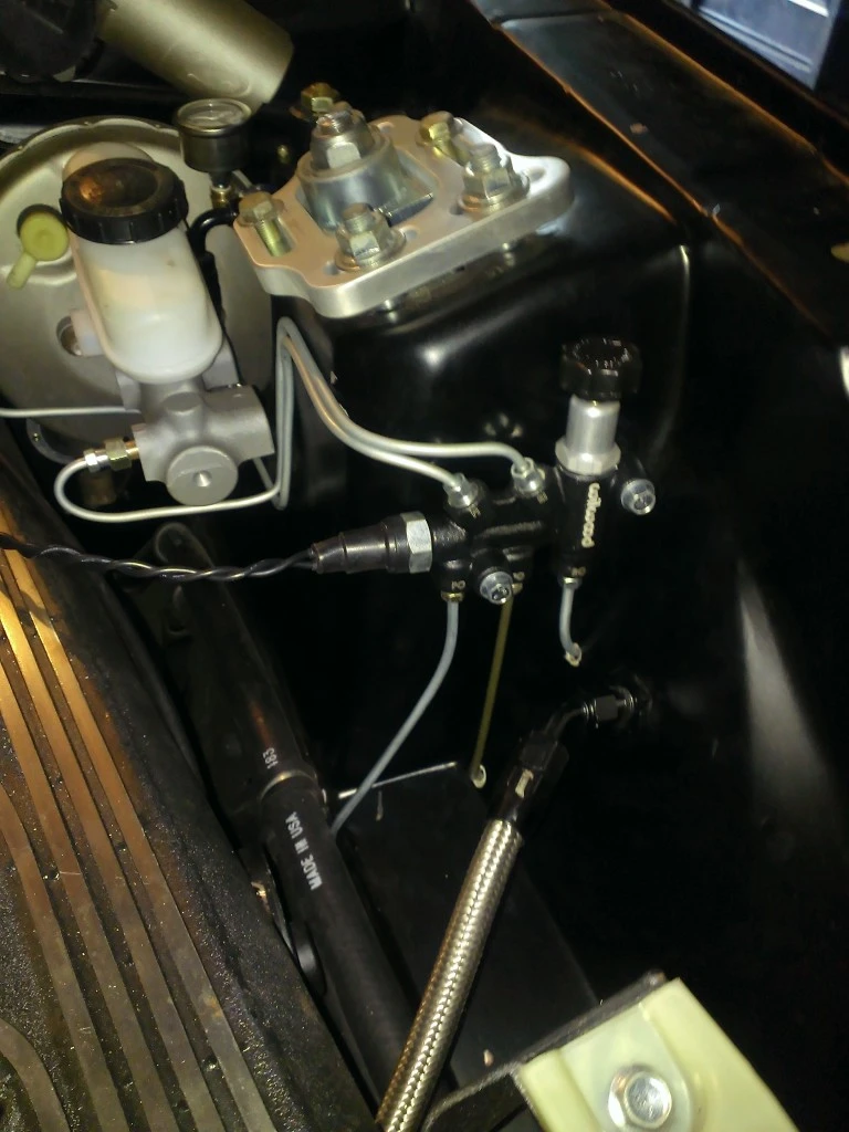

Secondly, When compared to the strut tower butchery that has to take place when a Cobra booster is put in place,...mine leaves miles of room. Finally,... If you're gonna gut the stock prop valve and the use a adjustable unit located elsewhere to bias the rear brakes,..you may as well consider killing two birds w/ one stone.
