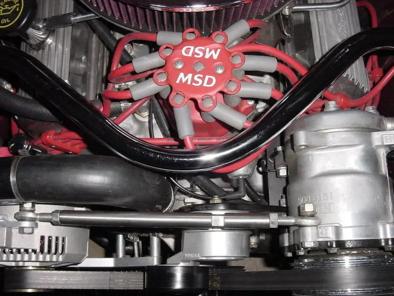

I don't know what accessory drive you have, but space is a factor with the vacuum canister. Sometimes it restricts the amount of degrees you can rotate the distributor to set the timing. You may have to pull it out and re-stab it one tooth. That is a pain with the hex oil pump shaft.
Here is a pic of how tight mine is. notice the modern 90 degree vac fitting to clear the tensioner bracket.

Yes, and the instructions are pretty good. Any time you change your cam, fuel or air setup, it's good to know you can tweak the spark to go with it. I think I went with blue on the springs and blue on the bushing and it ran great ever since.:nice:
