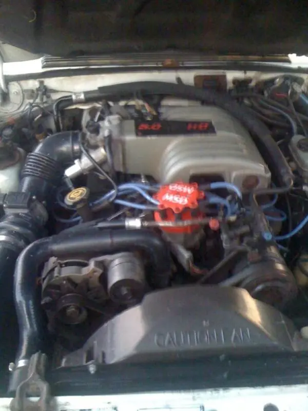

The first picture of what the distributor looked like before, the day i had bought the car and everything was working.

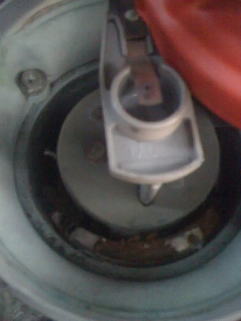

The second picture is what it looked like when i opened my hood last night.
(Keep in mind, I removed the cap myself. When i opened the hood initially the cap was still attached.)
The TFI has rotated about 45 degrees and is now facing the back of the A/C compressor.
How could it have done that?
I NEVER even touched the distributor before this. The bolt was never loosened, i only removed the cap once before this to check the rotor.
What is the deal here? I looked down inside the distributor and found two broken wires - a red and green one. both are obviously broken off of something, and there are chunks of what appears to be some kind of insulation all throughout the bottom of the distributor. It is tan in color.
I'm getting fed up with all of these problems, i tried twisting the distributor back and it wont budge. what could have caused this?

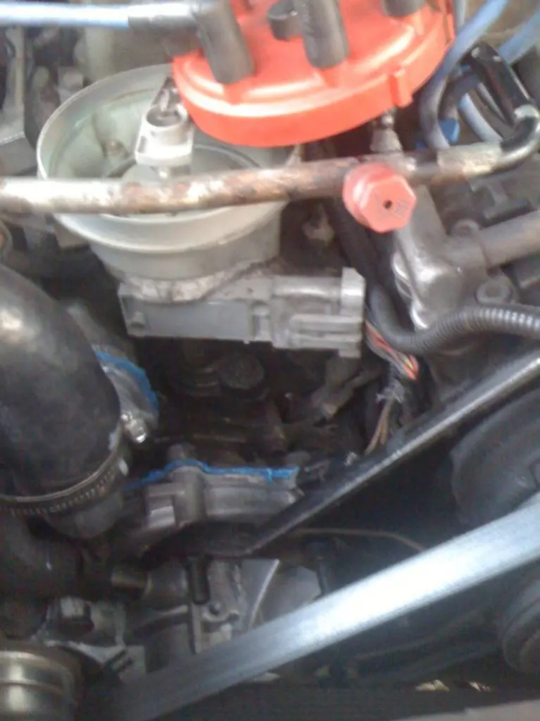

here is another picture, of what the inside of the distributor looks like. to the left of the rotor, you can see the exposed tip of the green wire, obviously broken off from something.

Looks like the hold down came loose, which will allow the dist to rotate... Check the hold down, right now it is just severly out of time and will never start. Pull the dust up to make sure the gear and shaft are in good shaft. After insepcting the dist if all is good bring the motor up to TDC and drop the dust back in and set the timing... should be good.
The green wire I don't remember, Ill have to look at schematics at the shop...
One time I had something fall down in the oil pump ( new pump, 2 days on it)(pretty sure it was a bearing out of the oil pump, I think it came apart internally) which completely stopped it from turning and inturn twisted the oil pump drive shaft around and around form top to bottom until it broke and it moved the distributor not that much though.

I cannot seem to win with this car, i took another look inside the distributor. All of the wires down inside it are torn to shreds, the insulation on the pip sensor is in pieces.
