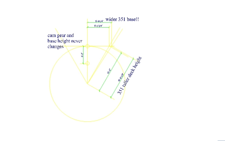

Throughout the past few weeks I have been trying to figure out what distributor I need to use for my 351 swap. I have had so many different answers that I decided to do a little research and this is what I came up with:
I purchased a distributor from MSD. I also have the one out of my H.O. 302 and measured them with a caliper. The base collar to gear length is the same on both pieces. The only difference is the shaft thickness. I thought maybe I'd gotten the wrong part so I called MSD's tech support and the guy was nice enough to go pull the parts and measure them while on the phone with me. He got the same measurements I did. The shaft is thicker on the MSD. The stock piece measured .40625 O.D. with a .21875 input ( a little more than 3/8" O.D and a little less than 1/4" I.D). and my new MSD for the 351 shaft measured .53125 O.D. roughly a 1/4 inch difference or 1/8th all the way around. with a .3125 input (a little more than 1/2" O.D and little less than 3/8" I.D) so
I have installed my MSD piece and it fits nicely. If you are on a budget and need a cheap 351w distributor for your swap you can pick one up from advanced auto parts for $79.00 or buy a direct Ford replacement distributor for $129. Neither will come with a T.F.I. module. Neither of these distributors comes with a steel roller motor gear. They can be purchased however, through Summit Racing.
I will include all part numbers at the end of this thread. Gear removal is quite simple. On after market distributors such as Mallory or MSD the shaft might be a little long and require some minor trimming. You need some end play but not much; just enough for oil to pass to the gear. My MSD unit didn’t need any but each application may vary.
Contrary to popular belief you can not use a lightning distributor. The lightning’s used the 1990 and later EFI distributor. On those models, the P.I.P. module is controlled separately while on the 87-93 5.0 and 1989 ford truck (5.8 only), the P.I.P. is controlled through the T.F.I. and has only one harness. You might be able to wire up a newer modle distributor to work but why do that when you can purchase a direct replacement. Well that about sums it up if I missed anything guys let me know.
