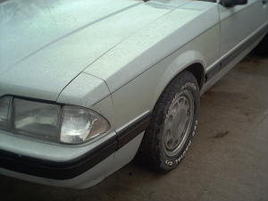

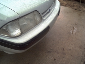

i'm sure everyone has already done it...but i just did mine yesterday...hellavulla lot cheaper than paying 40 dollars plus shipping for clear corners...and it doesnt look half bad!just thought id let ya'll know... :D too bad im selling the car...

ive always seen em for like 40 bucks...i am guessing nobody needs a walkthrough..heh...pics soon to come...as soon as i can figure out this "worlds smallest digital camera" b.s. heh

yep...razorbladed the cement outta them....the razorbladed the amber out. then i jb welded em back together nice and tight. they look really good. 'ello mark...guess what? made your new car have clear corners!

:D btw mark if i have enough time before you buy the car i might find a rear swaybar for you...make it more fun to drive! you should stop by and see the headlights sometime...just remember to call me beforehand

when you do your own clear corners make sure you dont plug up the vent hole on the bottom with glue or you could have fogging issues you have to leave in the orange bulb unless you want a ticket
