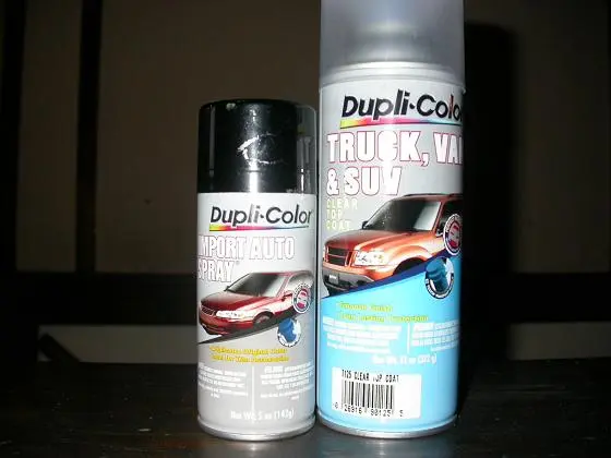

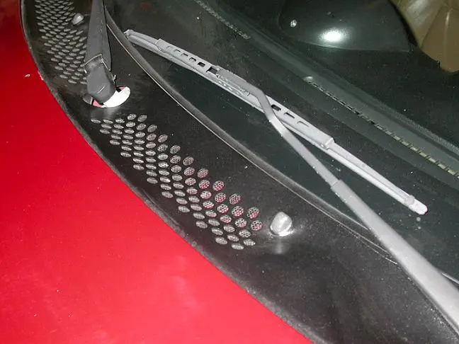

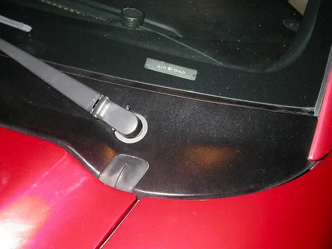

I used this paint on my cowl early last summer. I finally got some pictures of it this weekend. Keep in mind that the car is pretty dusty since it's only been washed once in the last 9 months, but you should get the idea. The cowl is a nice beautiful black, not too shiny and not too dull.
I simply removed it from the car, washed it with soap and water, then water, then let it dry. Next I put about 8-10 very light coats of black. Don't put it on thick or it may run and you'll also loose the much desired (IMO) texture. Once you have a good coating of black, put a couple light coats of clear on. Allow to dry for 24 hours before reinstalling. I painted it completely in 1 night and installed it the next day. It looks beautiful, next time I go home I'll try to wash the car and get a couple good outside pictures.

yea its not hard to paint and looks nice.. Does give the front end a longer look, when painted the cars color. Anyone doing this, i would suggest pulling off the mesh grill from the backside of the panel, and painting it flat black, to also mask off the rubber seal/lip on the top of the panel, and to mask off the little wiper squiters.. makes for a clean look when done this way, IMO.

:rlaugh: I painted mine like a dunce and it started peeling like a mofo afterwards and flaking all over the car! :bang: I had to pull it back off and strip it down and painted it again also. :p
Forgot to add, I painted the black strip, figuring that it would peel off, but it never did. That was only with 1 summer outside though, it's been in the garage ever since.
Also, the window squirters pop out, you don't have to mask them off. :nice:
