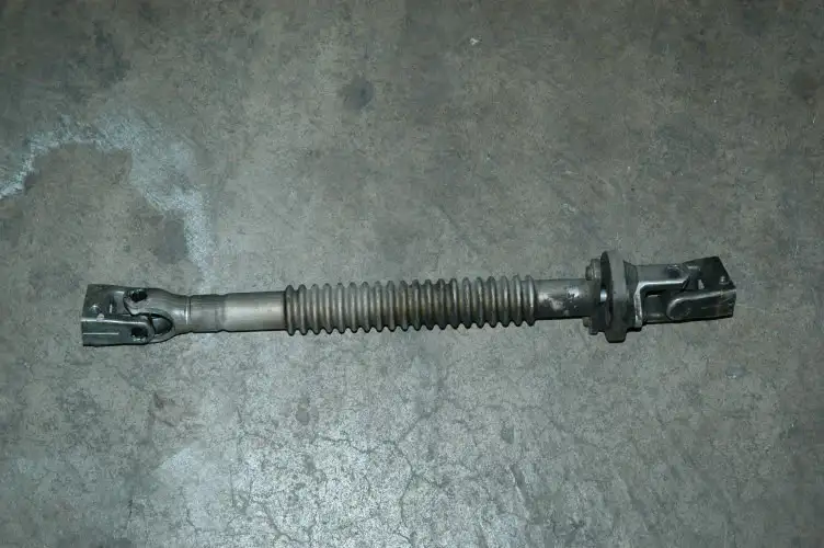

Everyone know that the stock mustang lower rack joint on the steering shaft sucks ass. It makes the steering feel horrible and you loose response over time. So owners are forces to replace them sooner or later...i know i have.
Many of you know about the MM Solid steering shaft upgrade and how good it feels...
Maximum Motorsports :: The Leader In Mustang Performance Suspension
But Many people (Including Myself) are turned off by the cost of the MM part at $250. No doubt, the MM part is amazing, but when you can pick-up a low milage shaft off ebay for $20 as a replacement.
Since the weak spot is that damn rubber rag joint, then what if we could just replace the rag joint with another piece....maybe something out of Aluminum.

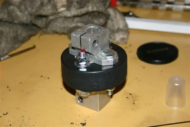

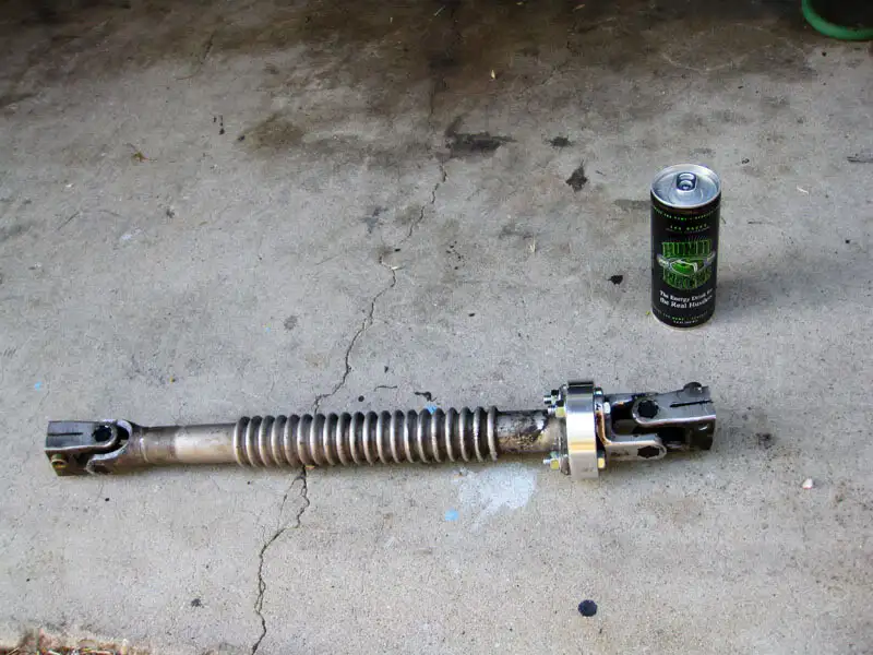

Well, i was reading other forums and noticed that BMW owners do the same thing because they have the stupid rubber joint. This Dude replaced his rag joint with a Aluminum unit. I also was reading that some E36 BMW owners even use a Hockey Puck.
Do you guys think this can be done on a Mustang 96-04? If that is possible that i might try it very soon....
Stock Z3 Shaft
Aluminum unit
E36 With Hockey Puck Replacement

But whats so bad about a hockey puck.
Since i noticed this i have been looking all over other forums and found out some things.
Hockey pucks are strong. They take 100MPH hits to a wall. They are made out of Pre-Impregnated Urethane. VW guys used them as Motor mounts and off road guys use them for lift kits.

When I saw this thread I thought it was a great idea so I built an aluminum one this weekend and installed it. There is a noticable difference in the steering responce. I will report back on how it works out. If I can get my camera to work I will post a couple of pictures.

I think the concern with using a hockey puck, or at least my concern, would be the repeated and sustained exposure to underhood temperatures and the urethane breaking down. If they're made with an acrylic urethane, it'll begin breaking down around 160-170° F. Being right next to header primary tubes, I'd be afraid to take that chance.

The hockey puck or aluminum has no flex the u joint and “rag joint” can flex for some misalignment with movement and vibrations. Rebuilding the joint sounds like a better idea to me for a longer lasting vehicle.
Delrin should stand up better than a hockey puck if you are doing it anyway.
