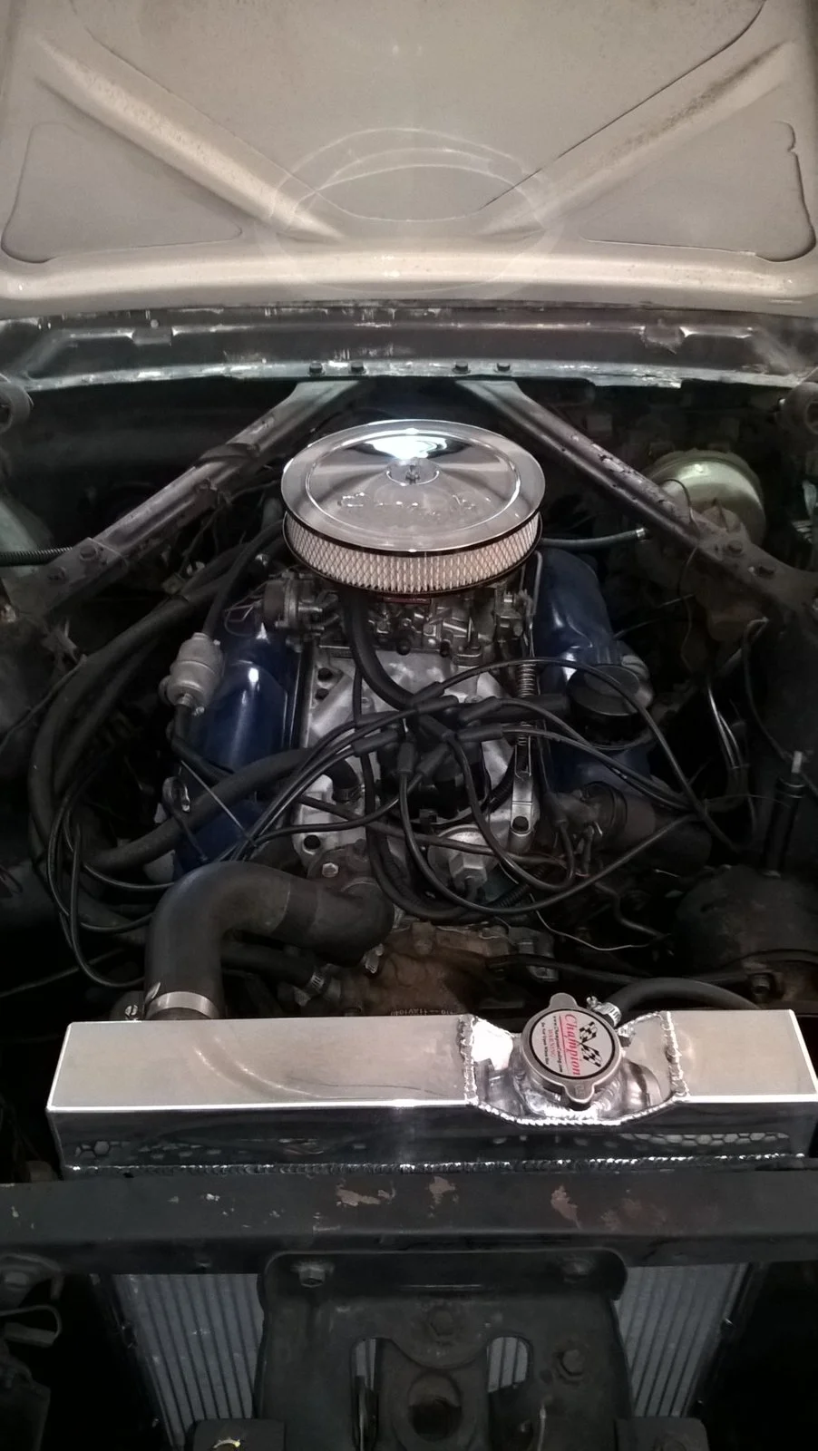

Hi, we changed the radiator on my sons 65 Mustang, Its aluminum. My son says the car always run above the middle and high when idling for a while. I know the cooling system is working and we just replaced all the fluid. I looked for a larger radiator but did not find one that fits. Besides I already put the new one in. Is that just the way they run or is something wrong?

Yes they do. Make sure your thermostat inside the gooseneck is a 189 or 190. 160 opens too frequently and causes heat build in the radiator. also install some kind of recovery jug if you don't have one. Two months ago I added a 16" electric fan to the front side (the side I can see in your picture) with a fan and Haynes fan controller. The customer is always in parades driving slow or stuck in stalled traffic in his overgrown town. He wasn't getting the additional air flow that you get at normal cruising speed. He said it helped a lot at slow speeds. I hope this helps !

Next, I cannot tell from the pictures if you are running a good fan shroud or not. The shroud is critical especially with a mechanical fan.
