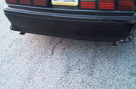

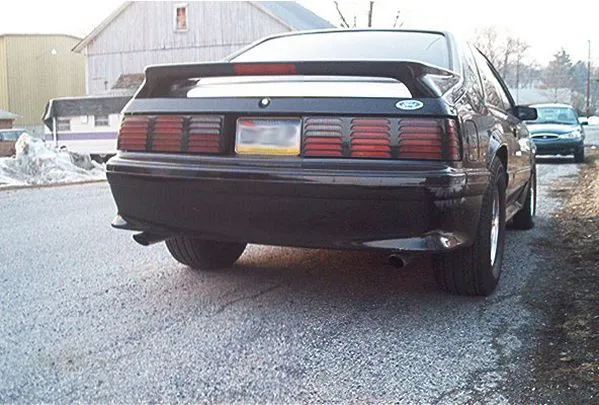

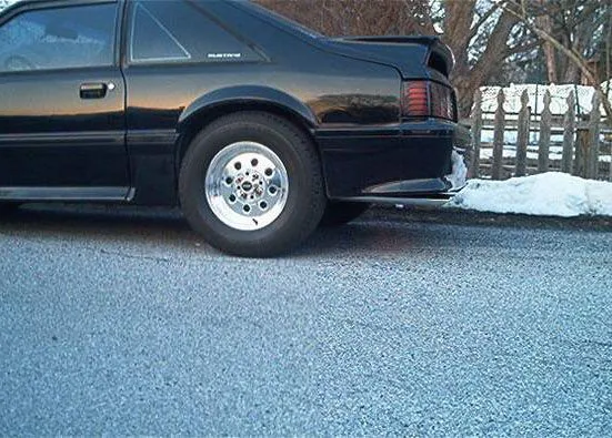

you're probably thinking of something like this. it's just a mac catback. the ball and socket joint for the tailpipes is after the axle, not before, like all others. i just angled it down some. i don't think it looks gay!

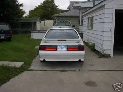

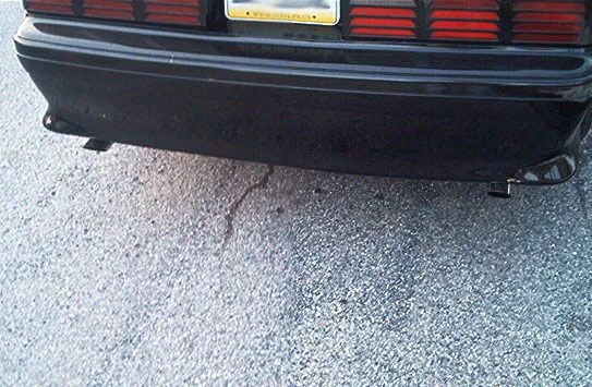

I think there talking more like this. This isn't as bad as some of the ones I've seen. The ones that are cut out to put 3" tips through them are just horrible IMO.

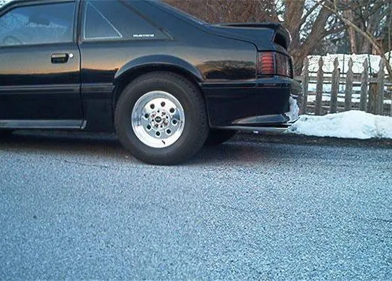

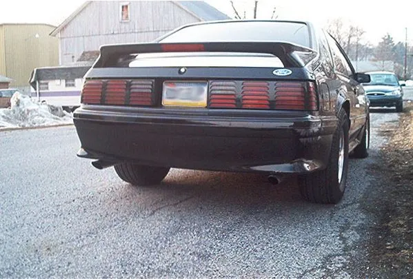

look at this, did it myself, always been told they were the best GT cutouts people had seen. More pics at the link in sig.:
attachment.php
Regrettably, my bumper was destroyed in an accident a few weeks ago, so as soon as my parts come in the car will be sporting a Cobra rear, Stalker front, Cobra R hood, and Saleen wing from Cervini's. I always liked the unique look my car had, and alot of people did too, but now I'm forced to go for a new look.

The car is red, that color is a result of road dust, exhaust soot, and bright sunlight. No company that I've ever seen makes a bumper like that, but an hour or so with a dremel and a marker and you've got it. The secret to making it look good is to add a molding. I used rubber fuel hose, slit it on one side, and fit it to the bumper. It cleaned up the edges, and molded to the tips. The rolled edge tips also help, as they match the shape of the GT bumper, as opposed to regular thin tips which look hack.
